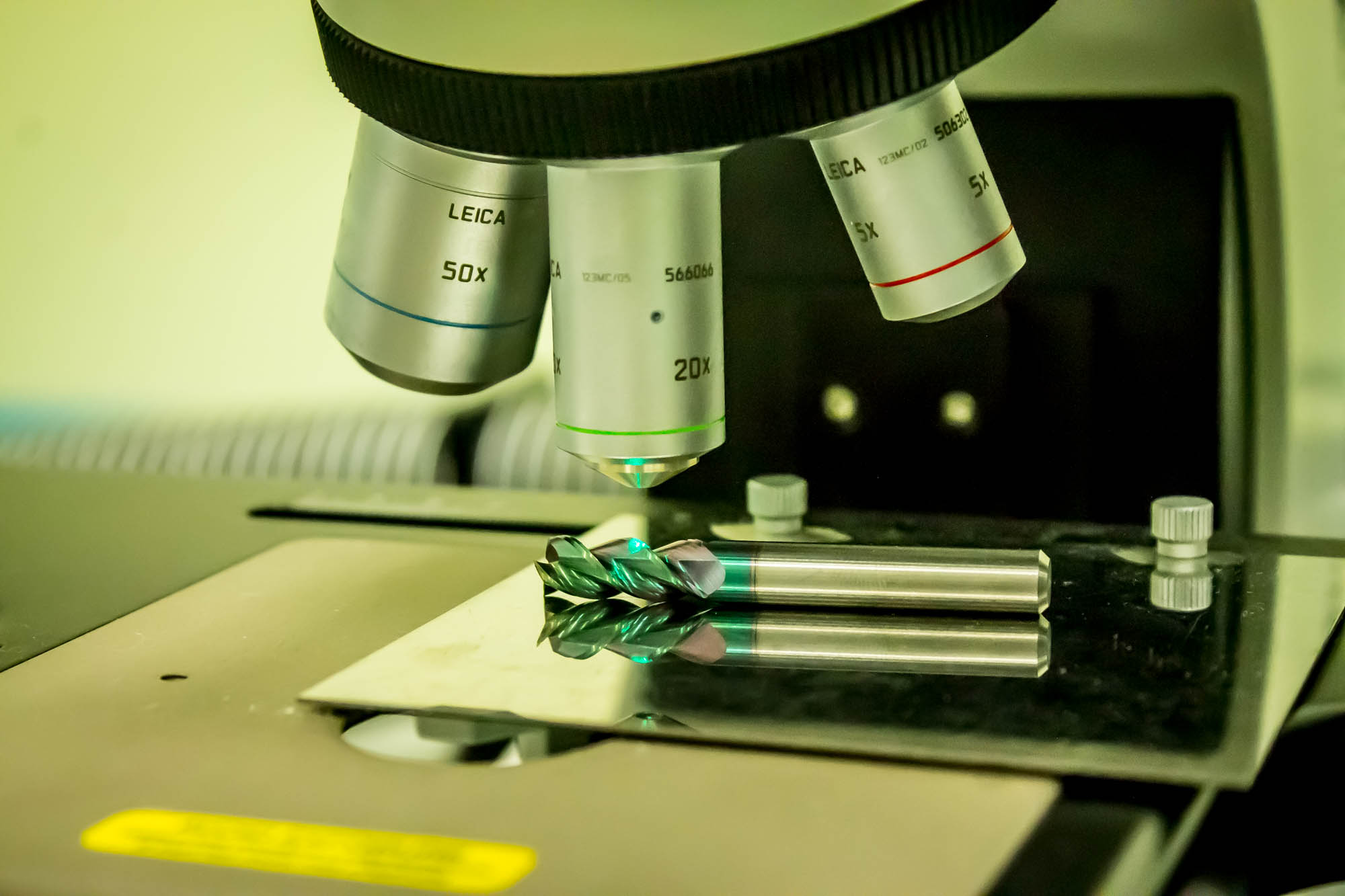

NPT uses a Renishaw inViaTM confocal Raman microscope to control the quality of the coatings and help improve processing methods. The inVia's high spatial resolution makes it an ideal instrument for the analysis of DLC; its benefits include: little or no sample preparation; it is safe and efficient to operate; it is easy to use; it enables the rapid collection of high quality data without damaging the sample; and it acquires repeatable, reliable data.
Renishaw inVia confocal Raman Microscope at New Plasma Technologies
