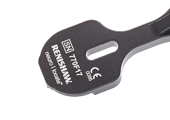

neurolocate serial number
2. The fiducial marker frame is identified within the software (using its serial number), to load the correct calibration parameters.
