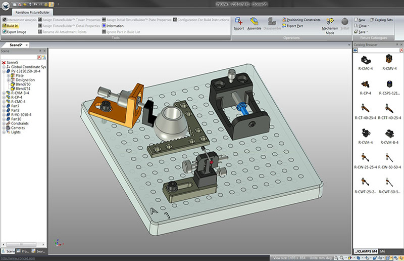

Clear and well-organised libraries
All standard base plates and fixturing components are conveniently organised into tabbed catalogues, grouped by component category and thread size.
Intelligent 'Drag and drop' functionality
Simply drag and drop the components onto a plate or another component. The SmartSnap®* technology automatically aligns them while indicating the mating hole X, Y and Z co-ordinates.
Quickest way to manipulate parts
The TriBall®* feature allows FixtureBuilder software users to move parts independently in the 3D work space.
Easy-to-use constraint mechanism
The easy-to-use constraint function allows the inspected part to be accurately located on the fixture. The choice of available constraint modes includes: align, mate, concentric, tangent, etc.

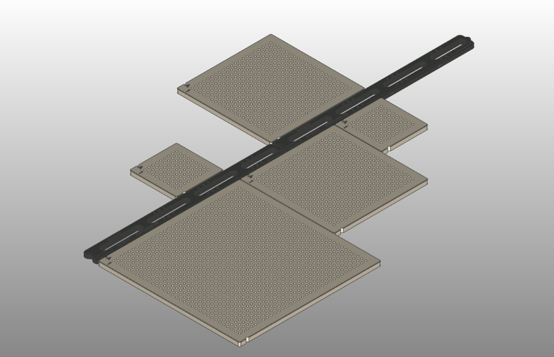

QuickLoad™ rail support
Design inspection fixtures for parts mounted on multiple plates, attached to the rapid, easy and repeatable QuickLoad rail system.

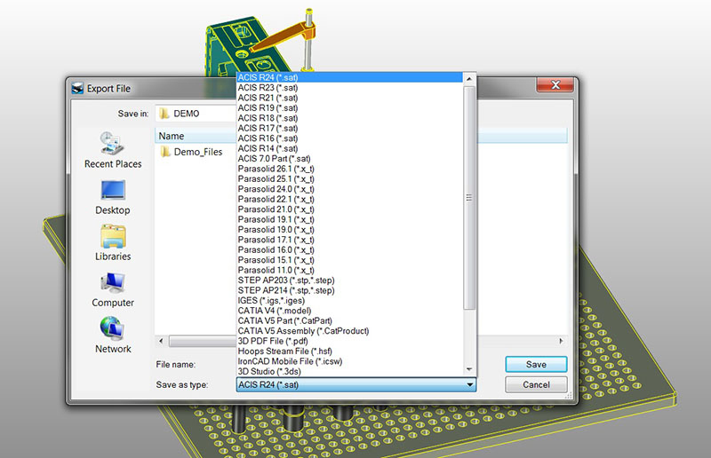

Full compatibility with 3D CAD formats
FixtureBuilder offers the ability to import and export most common 3D CAD files (Parasolid, Step, ACIS, STL, IGES, etc.).

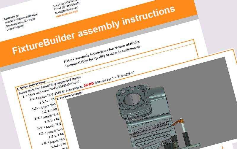

Meet the quality standards
Improve your compliance with quality standards. The ‘Build it' function is one of the key benefits available to all FixtureBuilder software users. It allows the production of a complete Bill of Materials and work instructions for every fixture set-up, and helps to comply with ISO, QS9000 and other quality standards.
