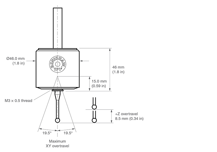

Dimensions
TP1(S) dimensions

Stylus overtravel (typical)
XY plane +Z axis
±19.5°
8.5 mm (0.34 in) @ 0.1 N
5 mm (0.2 in) @ 0.5 N
Maximum extension on PH10 series
N/A
