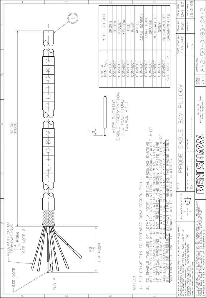

There are four individual cables in the PHS1 system:
  • Power cable
  • Comms cable
  • Probe cable
  • Overtravel signal cable
Maximum cable length is 30 m.
NOTE: It is recommended that the resistance of the power cable should be typically 3 W but should not exceed 5 W total loop resistance as a thermal fuse and switch mode power supply are configured to monitor the correct voltage to the head. High cable resistance may trigger the thermal fuse.
This is usually evident by the symptom of a brief power up, approximately 1 or 2 seconds, where the head LED lights before extinguishing. Exchanging heads may appear to solve the problem however this is usually due to electrical tolerance differences between systems.
PHS power cable 30 m PL104
PHS comms cable 30 m  PL105
Probe cable 30 m PL106V
Overtravel cable 30 m PL107
