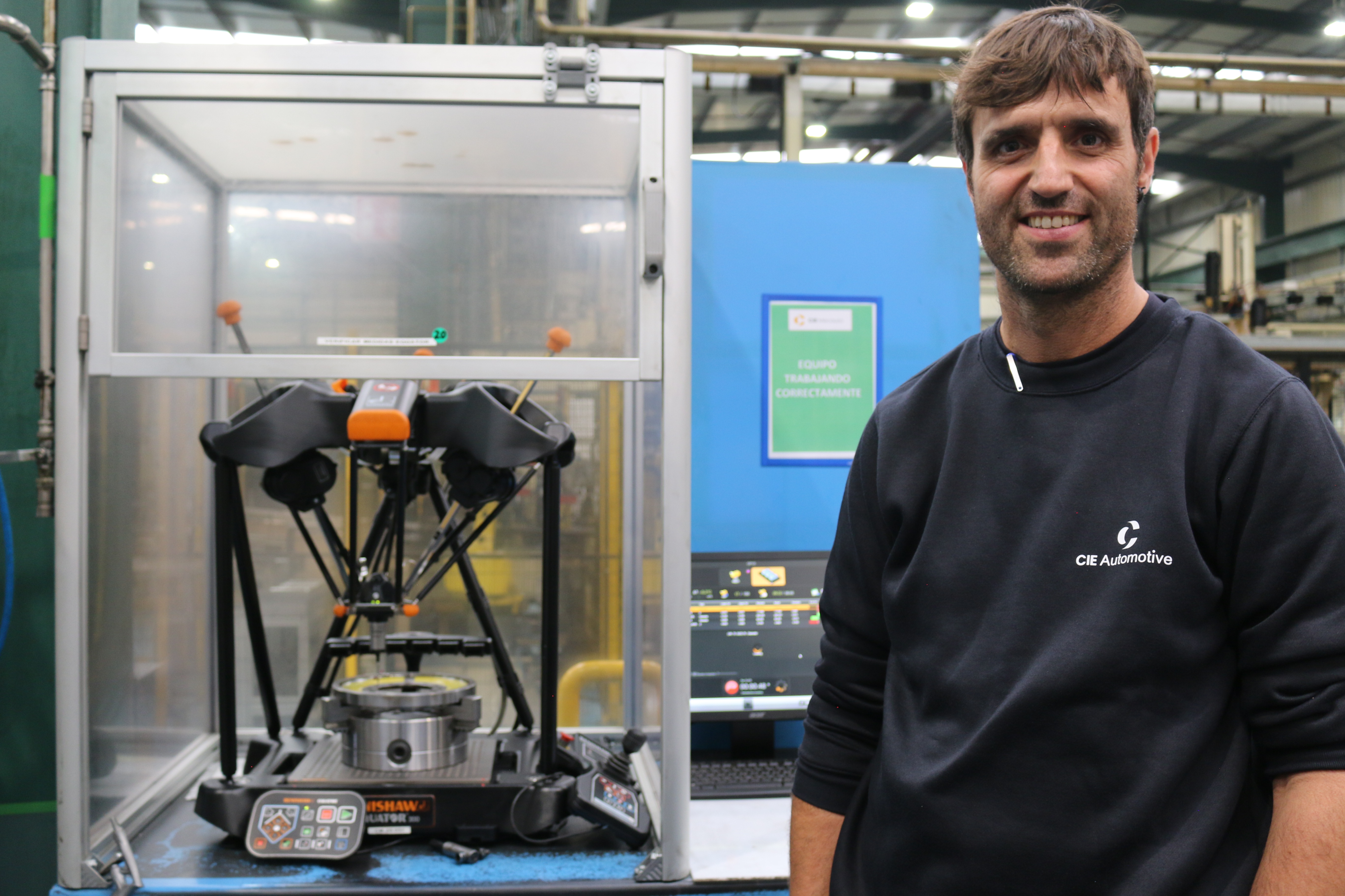

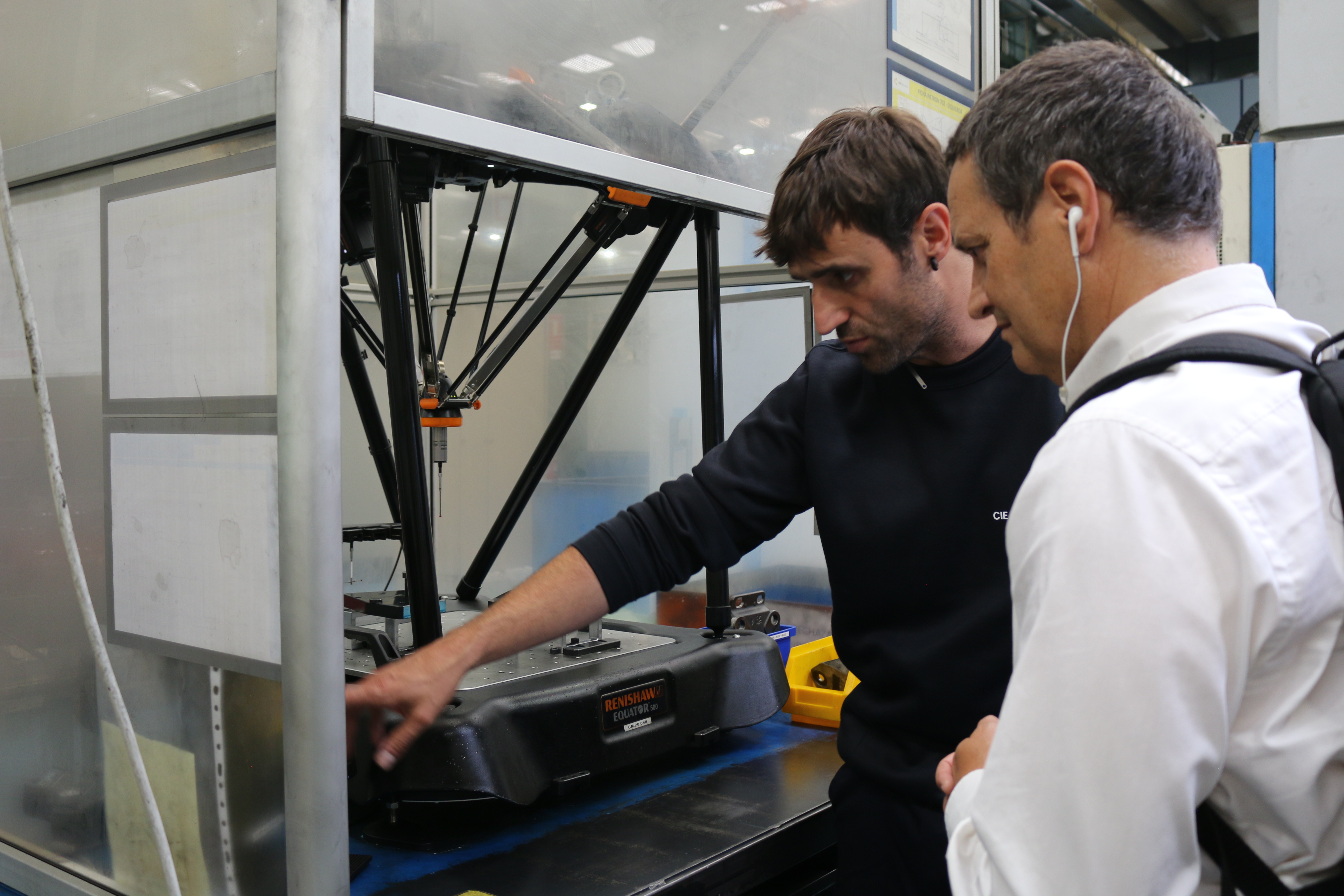

CIE Automotive has added the Equator gauges to complement their existing Renishaw machine tool inspection probes. These measurement tools are used every day.

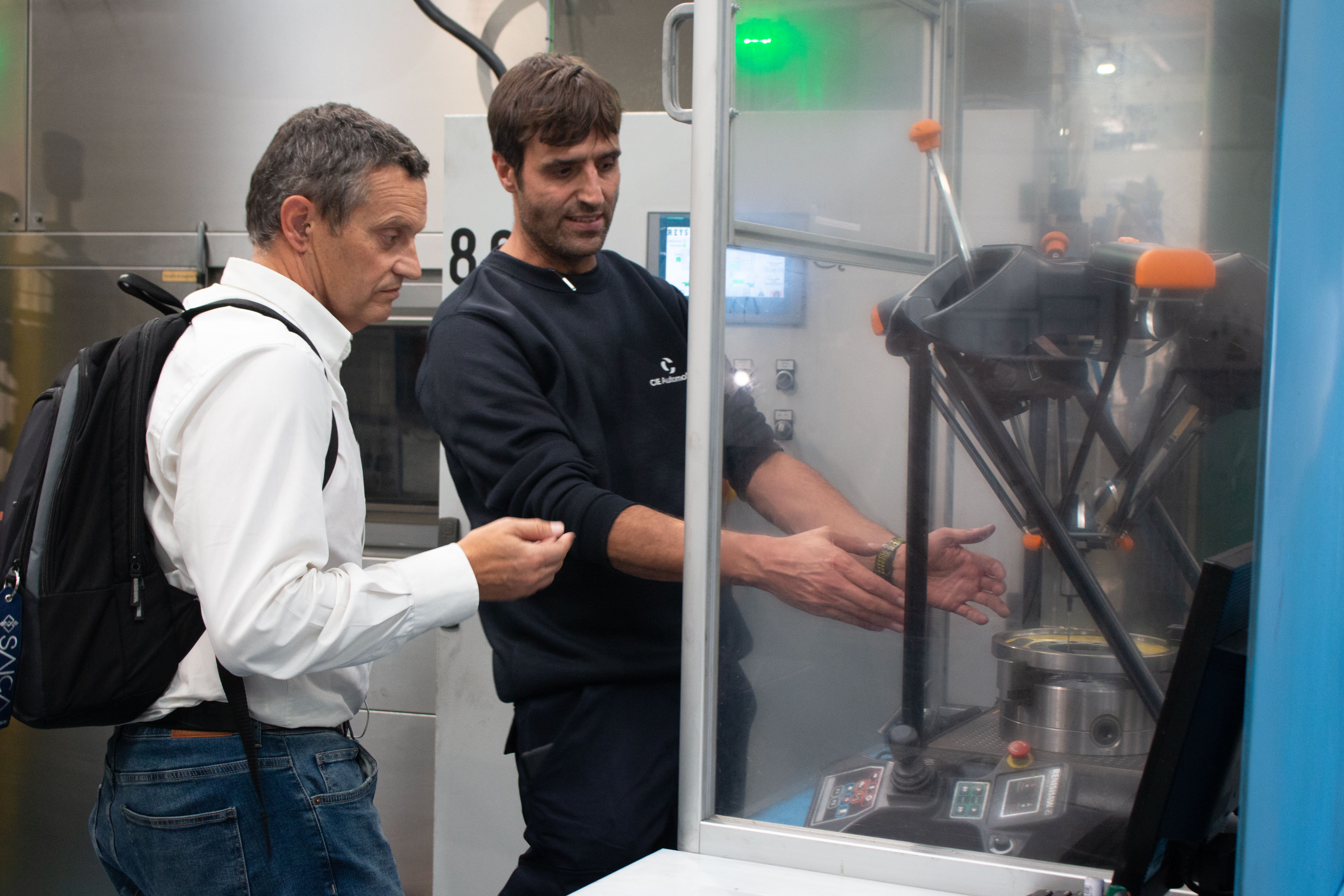

"Depending on the Equator systems available on site, we operate across three shifts. The Equator 300 gauges are used five days a week, while the Equator 500 runs seven days a week. For the latter, in-line operator control involves checking one part per machining centre every hour," continues Otxoa.
