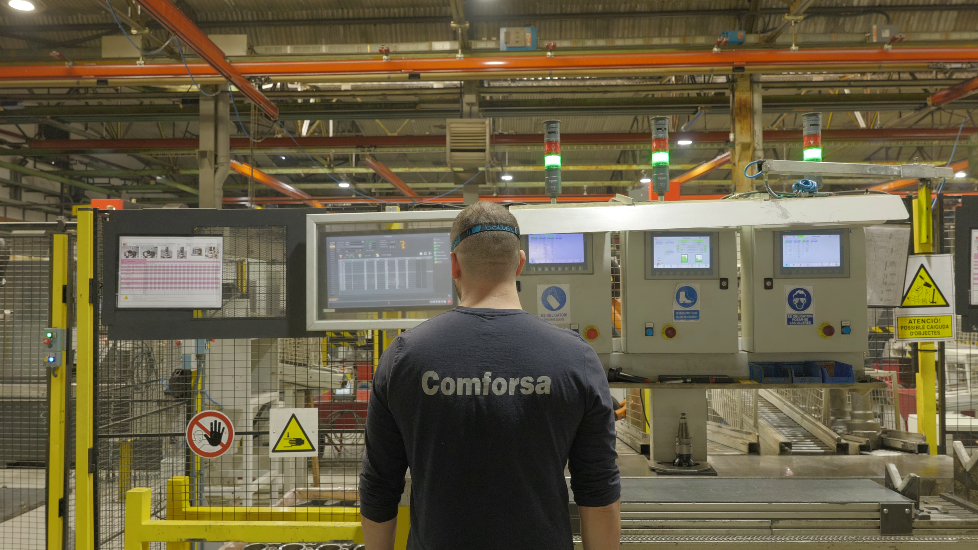

Equator system at ComforsaEquator system at Comforsa
Equator™ gauging system – automating efficiency, flexibility, and quality control
In terms of efficiency, the improvement has been notable. Previously, operators performed the inspections, which meant greater dependence on manual intervention and the risk of errors. With the Equator™ systems, we've reduced the need for direct labour while still inspecting 100% of the critical features. This automation helps us optimise costs and increase reliability.

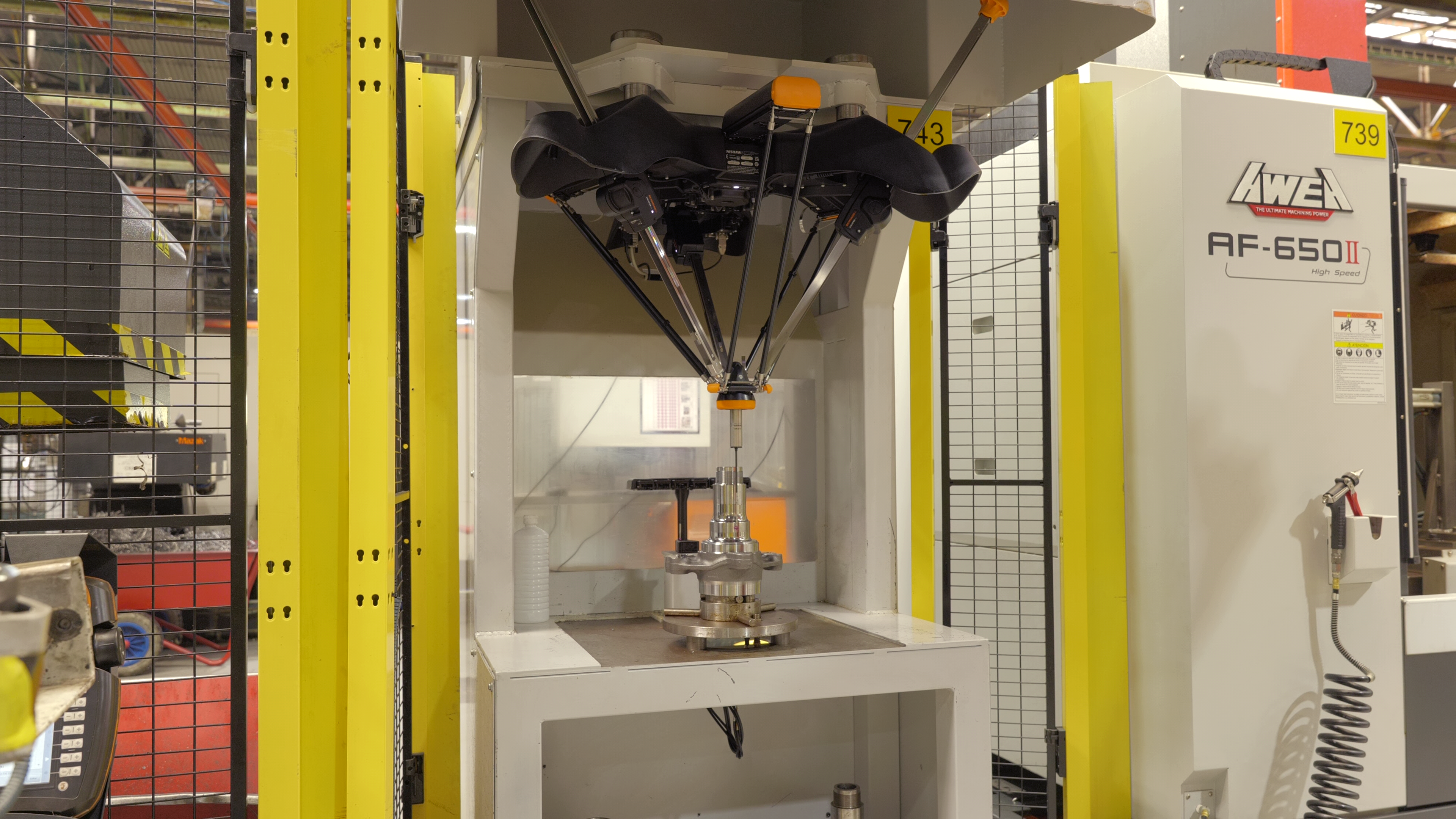

To improve production efficiency, Comforsa deployed two robot‑loaded Renishaw Equator™ gauging systems on two separate lines at the Comforsa-4 site.
On one production line, where output varies weekly, programs can be updated quickly to accommodate new parts. The system can switch between different parts in seconds. Changeovers are further simplified by the use of interchangeable fixture plates with repeatable kinematic location, without any impact on throughput. Together, these capabilities have significantly improved the efficiency and flexibility of this production line.
On a second, more stable production line with longer production runs, the Equator gauge's comparative measurement method delivers high efficiency through fast measurement cycles. Rapid re‑mastering also compensates for thermal variation, ensuring consistent process control.
