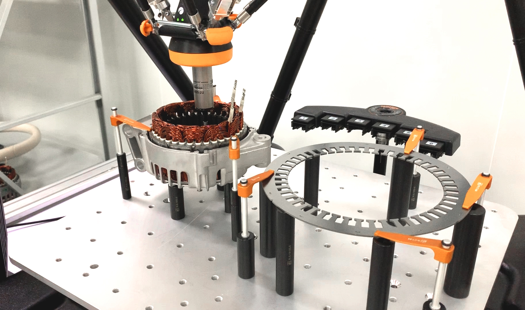

EV motors, generators, transmission gears and casings – all examples of parts where production lines and cells now rely on the process control capabilities delivered by the Equator gauging system, at the point of manufacture. Motor stators are a prime example – the high-speed scanning capability of Renishaw's SP25 probe used by Equator systems, coupled with Renishaw's powerful MODUS programming software, is ideal for assessing the demanding size, position and geometric tolerances on the ID and concentricity of an assembled EV stator – critical to guarantee motor efficiency.
The same Equator system can also use a Renishaw TP20 touch probe to collect single point data at a rate of up to three points a second – perfectly suited to gauging the relative positions of multiple edge points on a stator lamination plate.
