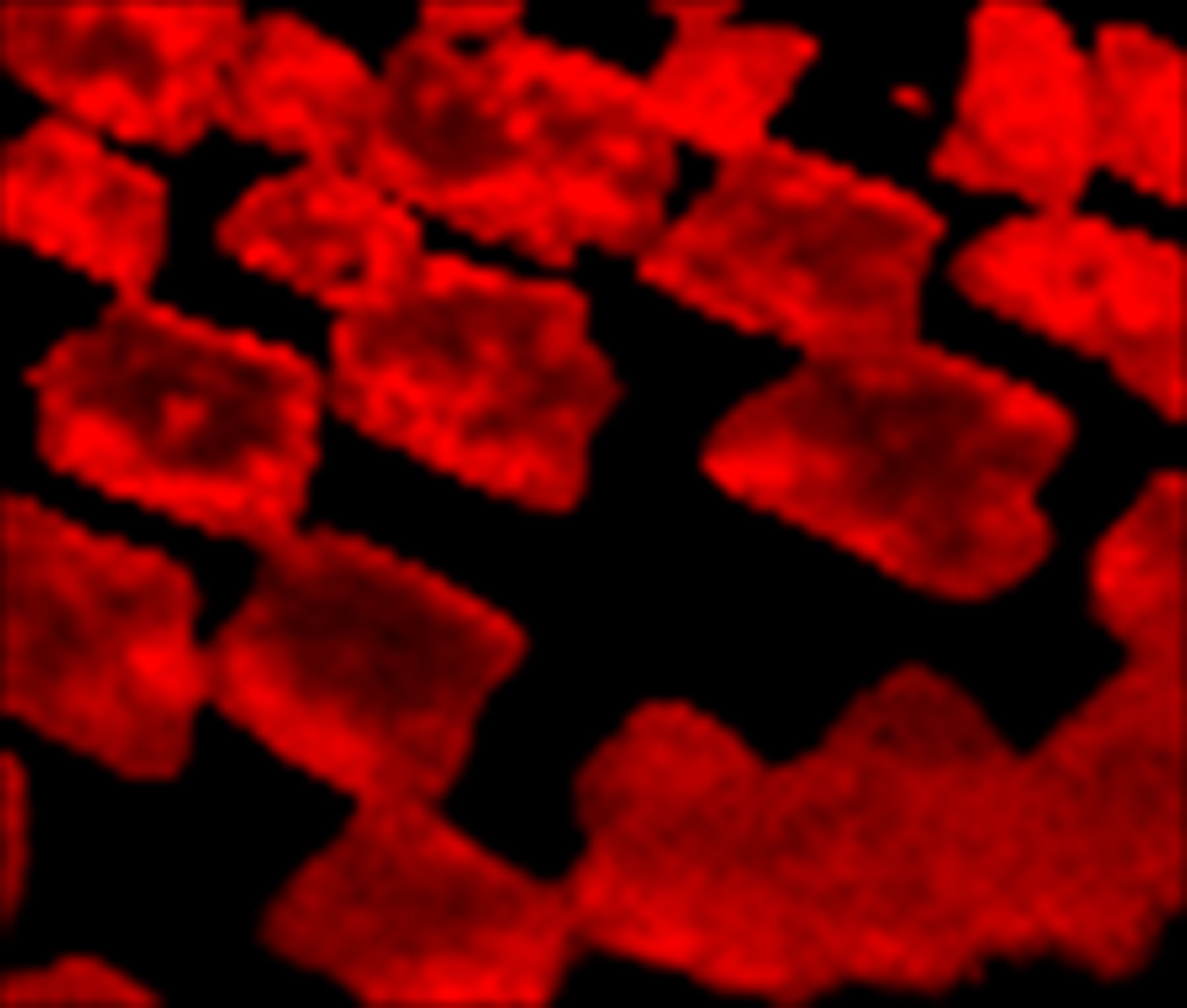

A Renishaw inVia Raman microscope has been used in new research that addresses one of the major hindrances to the wider exploitation of graphene: the difficulty in growing large defect-free films.
An international team—led by Oxford University scientists Professor Nicole Grobert and Adrian Murdock— in collaboration with Renishaw plc and researchers from the Forschungszentrum Juelich (Germany) and University of Ioannina (Greece), used a Renishaw inVia Raman microscope to examine film thickness, strain and defects in graphene films.
Graphene is a single layer of carbon atoms and was the first two dimensional material to be discovered. It has very interesting electronic and mechanical properties; it is one of the most conductive materials known to science and has a breaking strength 100 times greater than steel.
Typically, when graphene is grown using chemical vapour deposition (CVD), the individual graphene flakes merge with a variety of different orientations, creating defects. In this work, titled ‘Controlling the Orientation, Edge Geometry and Thickness of Chemical Vapour Deposition Graphene', and published in the journal ACS Nano, it was found that the orientation of the underlying copper substrate could be used to guide the graphene flakes so they are aligned, and these defects are prevented.
Team member Dr Tim Batten, Raman applications specialist at Renishaw, said, “The inVia Raman spectrometer is a very powerful tool for investigating the properties of graphene. This work gives a much better understanding of CVD graphene growth, which will be important for manufacturing graphene on an industrial scale.”

Image: Raman map of the 2D graphene band width for a CVD graphene sample. This image illustrates the variation in the number of graphene layers over the sample region, with bright red regions consisting of thicker material than darker red regions.
