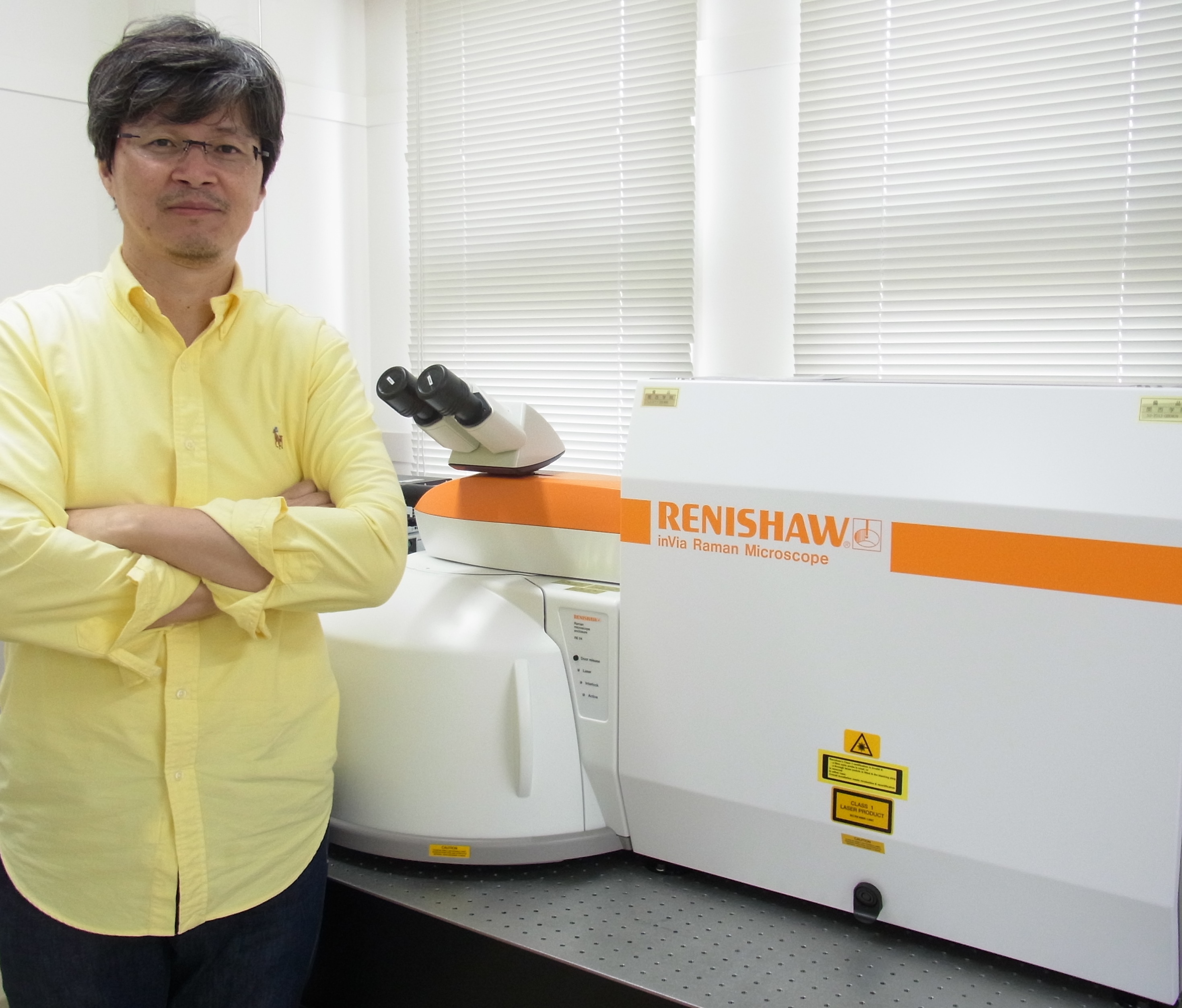

Professor Ohtani's laboratory also uses high resolution X-ray diffraction (HRXRD) to characterise stress distribution. Raman microscopy provides complementary information to the HRXRD data but with much higher spatial resolution. When asked why the inVia was chosen for the lab, Professor Ohtani said: “The key benefit is the ultra-high speed data acquisition system, which results in a higher sensitivity to measuring stresses in the materials compared to other Raman systems.”

Image: Professor Noboru Ohtani of the Department of Nanotechnology for Sustainable Energy, School of Science and Technology at Kwansei Gakuin University with his Renishaw inVia Raman Microscope.
