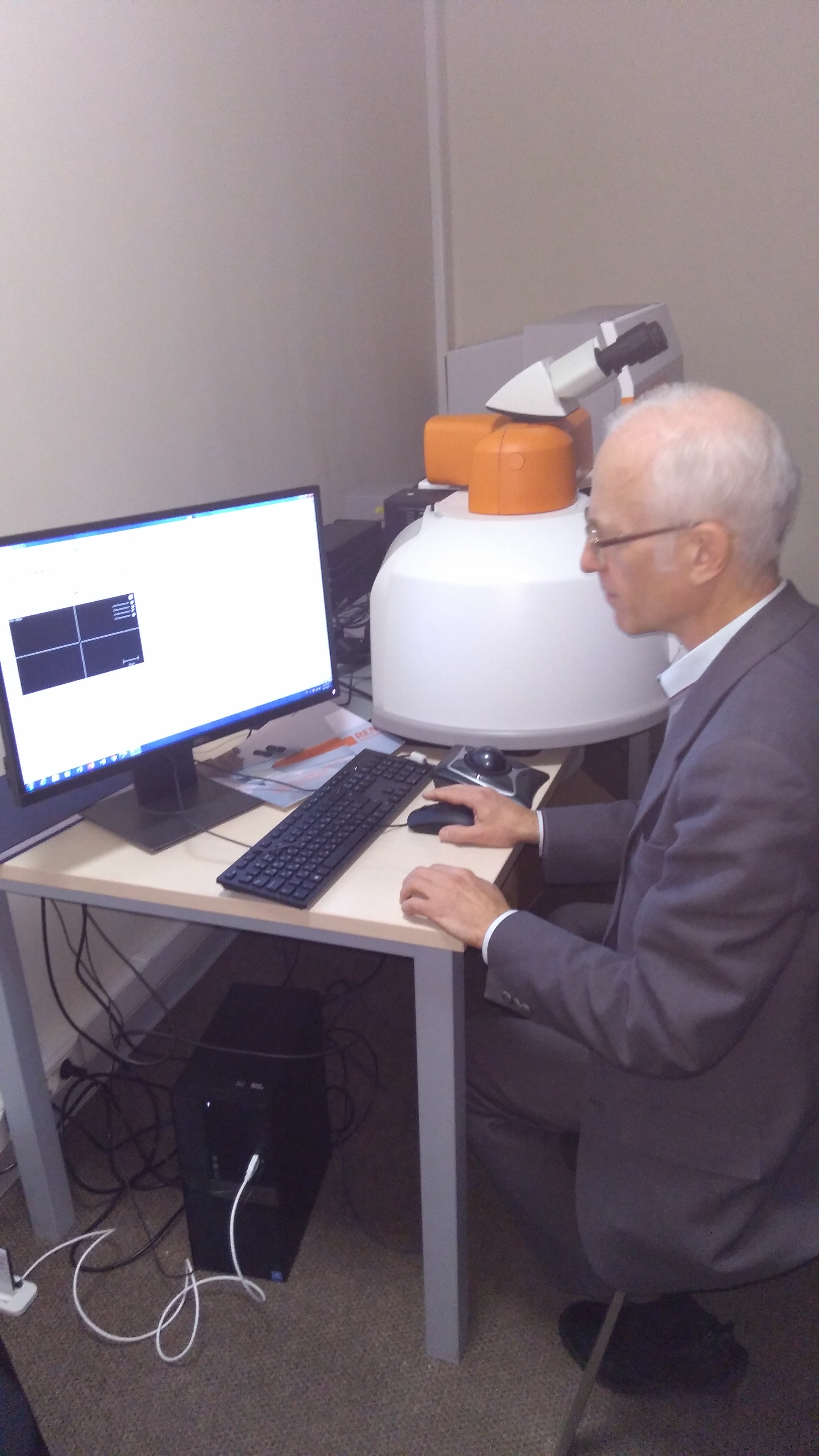

  • Dr. Victor V. Popov using an inVia Raman microscope Dr. Victor V. Popov using an inVia Raman microscope
    Dr. Victor V. Popov of the National Research Nuclear University MEPhI (Moscow Engineering Physics Institute) using an inVia Raman microscope
