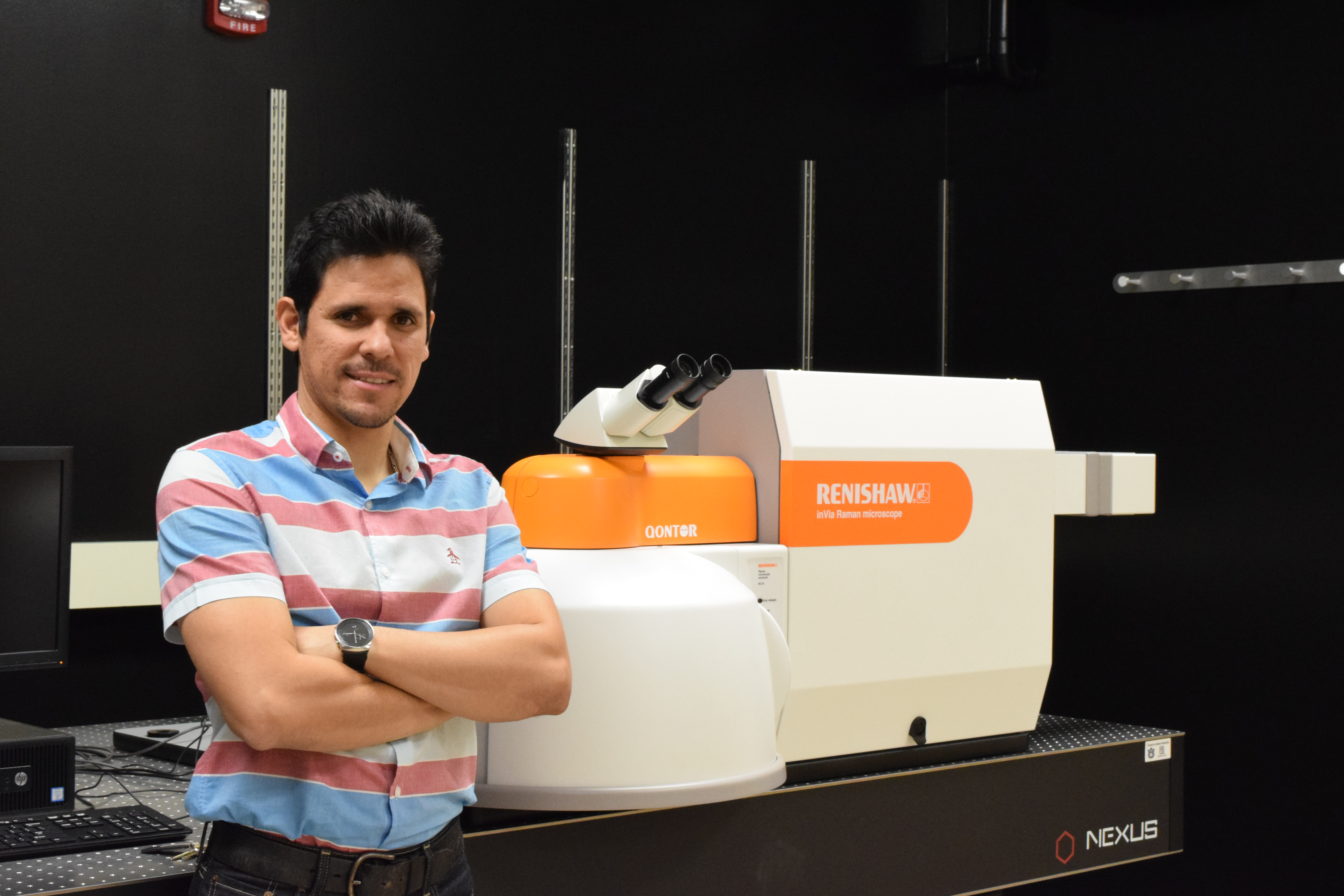

For this work, Prof. Carrero uses Renishaw's inVia™ Qontor® confocal Raman microscope because it gives high quality Raman data, when the samples are at temperatures around 600°C, with a high thermal background.
Describing his choice of the Renishaw inVia system, Prof. Carrero said, “The new inVia™ Qontor® LiveTrack™ feature, which maintains sample focus during the Redox cycles, is a remarkable timesaving advantage that, at the same time, provides reliability in the analysis. Also, it is quick and easy to change lasers to run specific experiments (e.g. quick calibration and alignment). As an academic, I find the inVia microscope very friendly to operate which has allowed me to easily train and engage both graduate and undergraduate students in the use of Raman spectroscopy for catalysis. In two years of intense work, the inVia system has demonstrated that it is very robust. Technical service has been very efficient in quickly solving any issues should they arise.”
