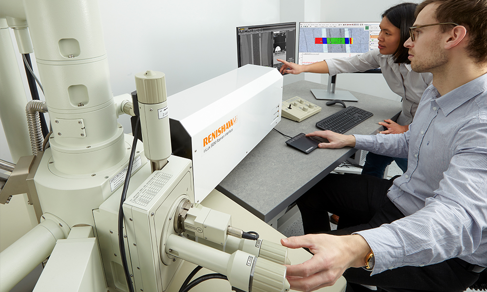

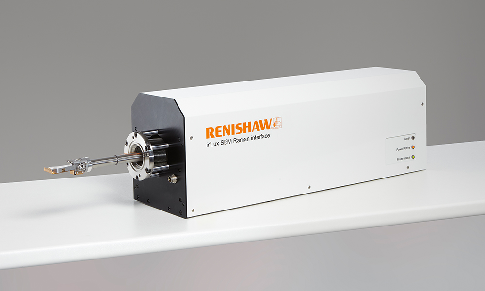

Renishaw, the pioneer in combining Raman spectroscopy with scanning electron microscopes (SEMs), has launched its latest product, the inLux™ SEM Raman interface. Adding the inLux interface to your SEM enables in situ Raman spectroscopy which provides highly specific chemical and structural characterisation to complement your SEM information. The inLux interface is compatible with SEMs from all major manufacturers and can be easily added to new and existing SEMs on site.

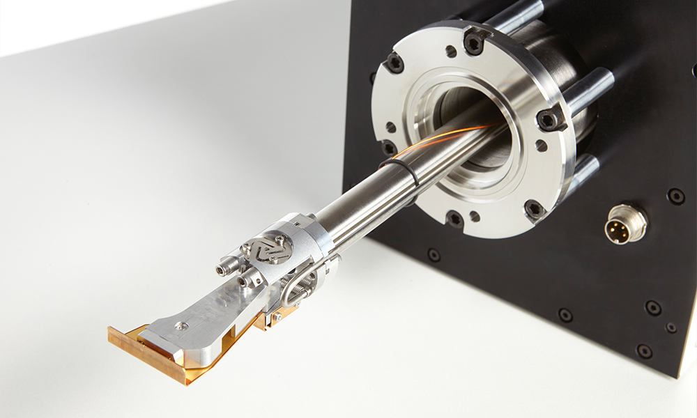

The innovative design of the inLux interface enables Raman measurements to be performed while the sample is under the SEM beam. This allows simultaneous Raman, photoluminescence (PL) or cathodoluminescence (CL) measurements with SEM imaging, making experimental workflows easier and faster. The inLux interface is used without any need to move the sample, even when performing mapping measurements. This enables simple and accurate correlation between the Raman data and SEM images. When not in use, the inLux probe can be withdrawn from the SEM chamber enabling completely independent use of the SEM.
The inLux interface offers a comprehensive range of Raman capabilities. You can collect spectra from single points, multiple points, or generate 2D and 3D confocal Raman images. The inLux interface comes fully equipped for all this work as standard, enabling you to analyse areas larger than 0.5 mm in each axis. Fully encoded position control, down to 100 nm, assures precise sample movement.
You can equip the inLux interface with up to three fibre optic modules, two different Raman excitation wavelengths from 405 nm to 785 nm and an optional CL probe. These modules offer flexibility when dealing with fluorescent or challenging samples.

Tim Batten, Renishaw's Spectroscopy Platform Product Manager commented, “Renishaw has been making combined SEM Raman solutions for over 20 years. The inLux interface is the culmination of our expertise. It has been specifically designed as an easy-to-use bolt-on SEM accessory, opening the world of Raman analysis to all SEM users.”
