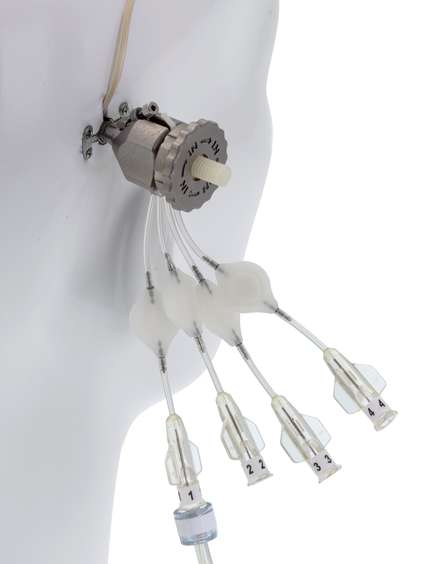

A novel drug delivery system that aims to enable pharmaceuticals to bypass the blood-brain barrier for the ongoing treatment of neurological disorders and brain tumours has been shortlisted for the TCT Healthcare Award. Global engineering company, Renishaw, designed and manufactured the device, which includes a metal 3D printed titanium port. The awards will be presented during the TCT Show which takes place at the NEC, Birmingham, UK, on September 25th.
It has historically been difficult to treat neurological conditions due to the blood-brain barrier, which acts to protect the brain against viruses, bacteria and fungi, as it can prevent drugs from accessing the brain. As a result, treatments require high doses that can lead to unwanted systemic side effects. The neuroinfuse drug delivery system acts as a mechanism to deliver pharmaceuticals directly into the brain, so that new therapeutic regimes can be developed to treat neurological disorders, using minimal doses for maximum effect.
The neuroinfuse chronic drug delivery system is composed of up to four catheters, which are implanted into a target area within the brain. The catheters can be accessed via a 3D printed titanium transcutaneous port implanted behind the patient's ear. Drug-filled infusion lines are connected using an MRI compatible, 3D printed, titanium application set, which repeatably locates onto the port. Retractable needles extend through a septum in the port to enable therapeutics in the external infusion lines to be infused through the implanted catheters. The port features a roughened surface below the skin to encourage bone integration and device anchorage, whereas above the skin, it is polished to discourage bacterial settlement.
The device holds promise for the treatment of a range of neurological conditions and brain tumours. It is currently being used in a Phase I – II clinical study with Herantis Pharma Plc, investigating cerebral dopamine neurotrophic factor (CDNF), for the treatment of Parkinson's disease. It is also currently being used on humanitarian grounds to treat children suffering with diffuse intrinsic pontine glioma (DIPG), an aggressive form of brain tumour that occurs in a difficult to access area of the brain. DIPG most commonly affects five to ten year olds.
“There is currently no approved method for the chronic delivery of drugs for neurological disorders into the brain,” explained Dr Max Woolley, Technical Fellow and Head of Drug Delivery Device Research and Development, at Renishaw. “This device has the potential to completely change how neurological diseases are treated. The port allows repeated delivery of pharmaceuticals over long periods of time, without the need for further surgery — patients can be admitted as outpatients for the infusions.”
“If we produced the device using traditional subtractive machining, we estimate it would have required up to ten parts,” added Woolley. “By designing for metal additive manufacturing, it was possible to produce it as one component, reducing the time needed for manufacture and the potential for error from unnecessary assembly operations.”
