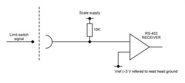

UCC MMI input circuit for CMM readhead - limit switch inputs:

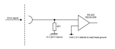

UCC MMI input circuit for CMM readhead – error input:
