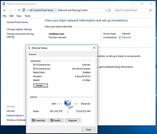

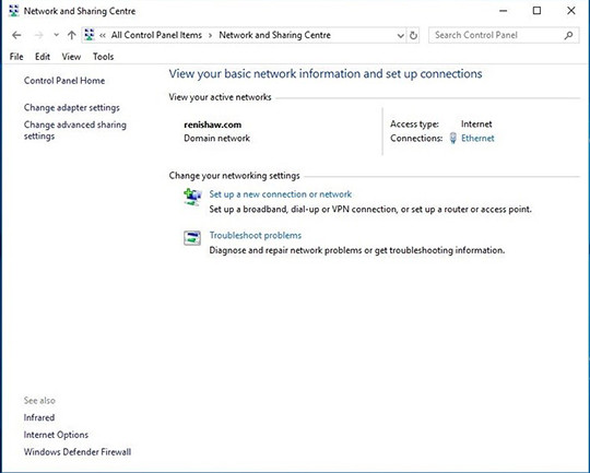

a) Navigate to 'Control Panel', then → Network and sharing centre:
Technical drawing:  Technical drawing:  Setting the IP address of the PC 1
Technical drawing: Technical drawing: Setting the IP address of the PC 2
