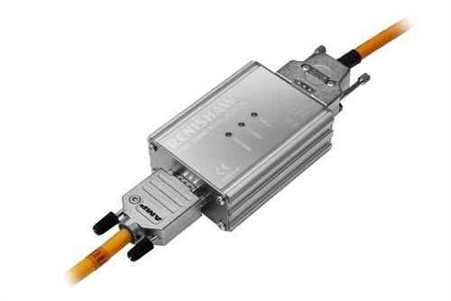

Head comms signal booster
The head comms signal booster has been designed for installations of PH20 and REVO-2 where cable runs of greater than 25 m are required
  • PH20 cable booster boxOne HCSB is required for each additional run of 25 m
  • The HCSB is powered from the machine cable so does not require an additional power supply – it simply connects between two machine cables
  • Functionally, the HCSB passes the power and motor connection for the probe head straight through and decodes and retransmits the information
NOTE: The HCSB is only compatible with PH20 and REVO-2.
