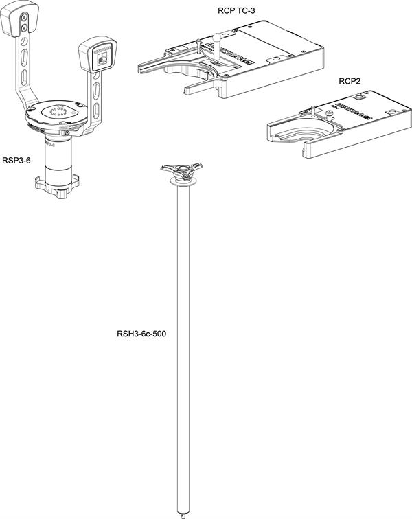

RCP TC-2 and RCP TC-3 are powered racks for use with the REVO probe range.
This rack maintains the probes at operating temperature whilst stored in the rack ports. This maintains metrology of the system after a probe change.
RCP2
RCP2 is a passive rack port for use with the RSH range of stylus holders as well as the SFS-# styli.
RCP TC-2, RSP2, RCP2 and RSH175 - labelled
RCP TC-3 with RSP3-6 and RCP2 with stylus holder
