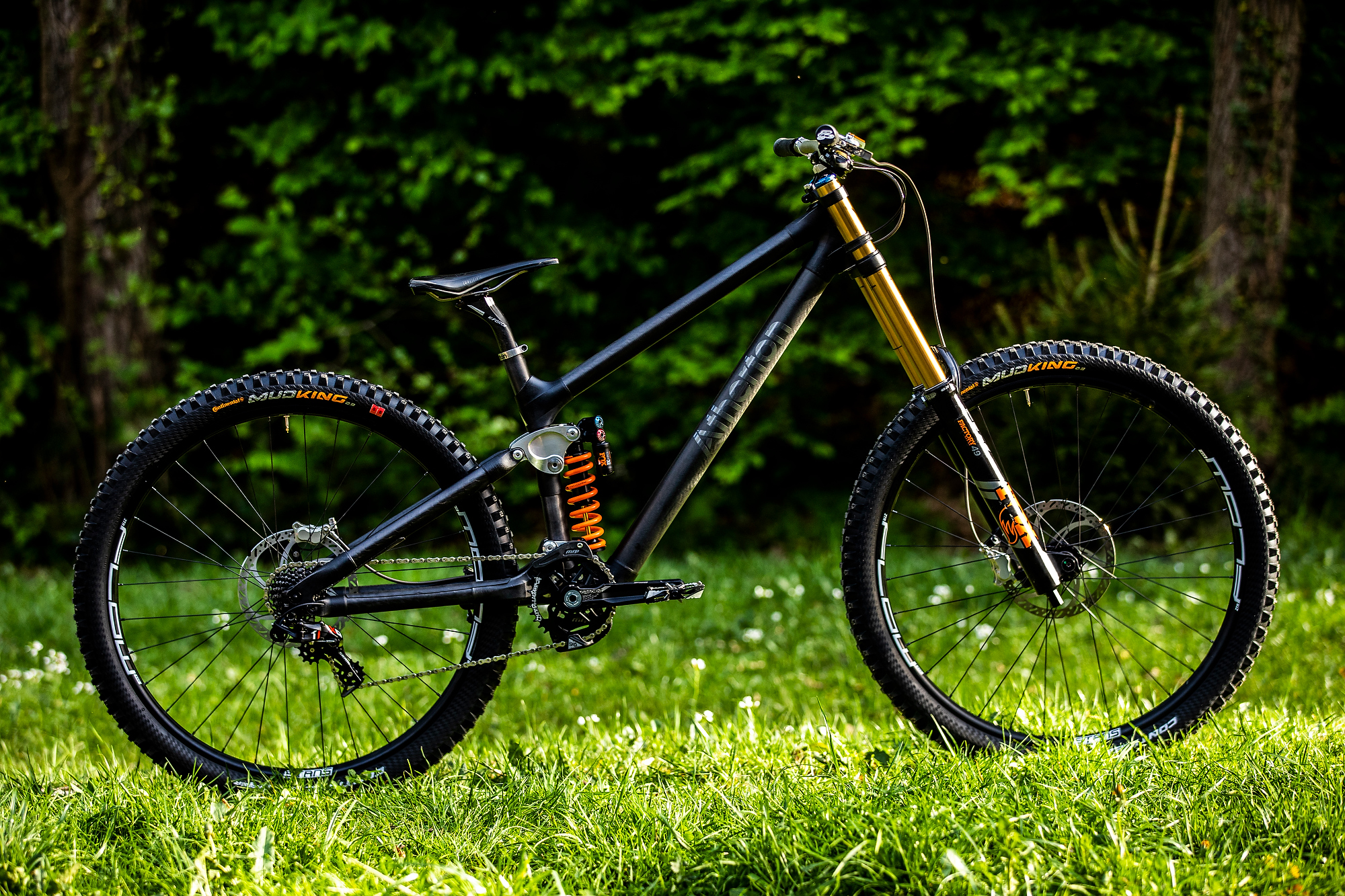

Renishaw is also contributing its AM expertise to help a variety of businesses develop new products. For example, Mountain bike brand, Atherton Bikes is working with Renishaw to additively manufacture titanium lugs for the company's bike frames. By using the RenAM 500Q, the company can increase production rates, quickly developing and customising parts to the requirements of the rider. Whereas traditionally a lot of tooling is required, additive manufacturing is an entirely digital process, meaning that the lugs can be modified in CAD and reproduced efficiently and to a high standard.

Atherton Bike Credit: @svenmartinphoto
