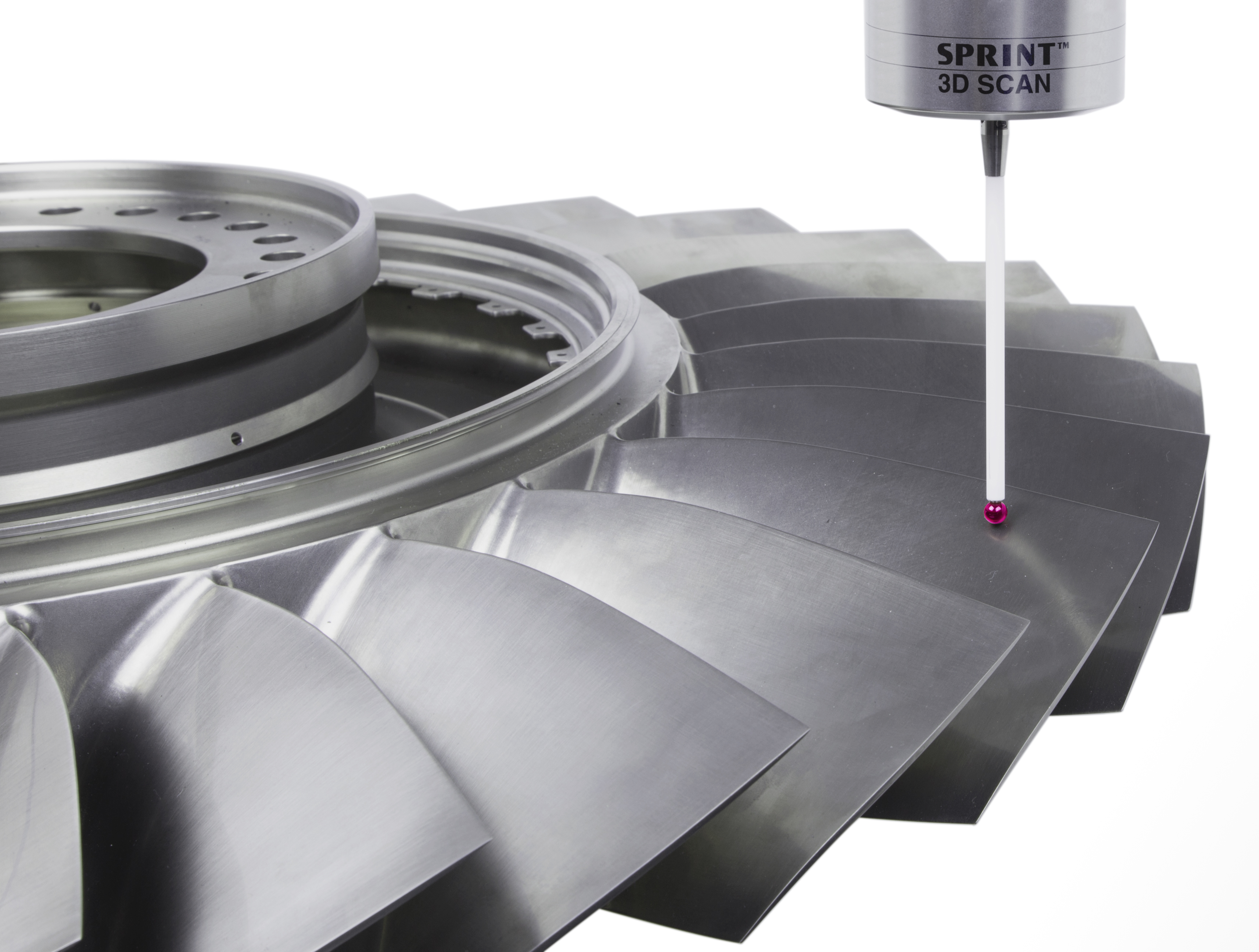

On-machine scanning solutions such as Renishaw's OSP60 probe with SPRINT™ technology can address these limitations, making probing viable in applications that were previously impractical. Unlike other on-machine scanning systems which only output data in 1D, the patented 3D sensor technology in the OSP60 probe can output 1000, true 3D (X, Y, Z position) data points per second, enabling true form analysis and defect detection at unprecedented feedrates.
The OSP60 probe, combined with a host of powerful software tools from Renishaw, provides 'real surface modelling' which can be used in a variety of different applications and downstream operations to dramatically improve production processes. Benefitting from the high density data captured by the 3D scanning system, applications include on-machine health checks prior to machining, part set-up and feature measurement, surface condition monitoring of flat sealing faces, 3D surface measurement for the manufacture of complex parts such as blades, and the adaptive machining of parts, such as castings which have variable form.

- OSP60 probe with SPRINT™ technology scanning a blade component

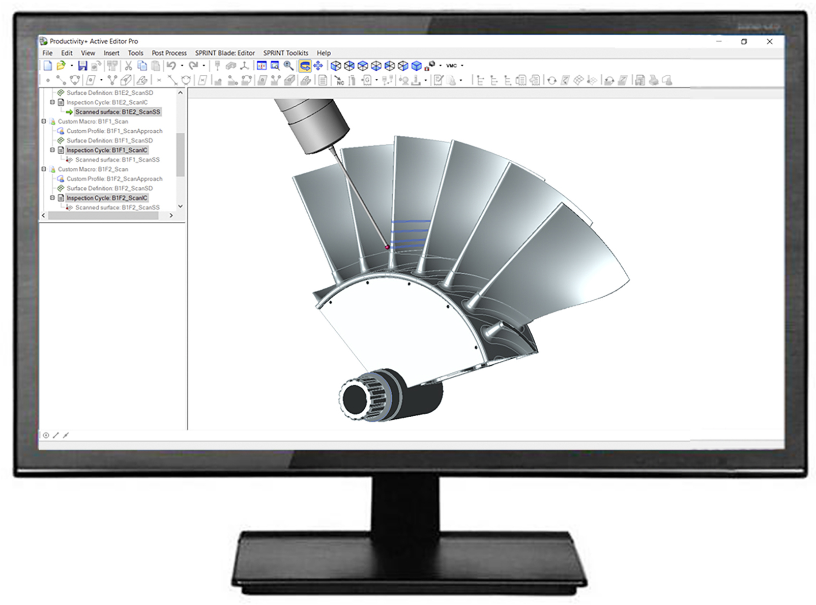

- Programming the scanning of a blade using the OSP60 SPRINT™ probe in Active Editor Pro using the Blade Toolkit
