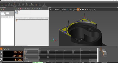

MODUS IM DMIS Programmer
MODUS™ IM DMIS Programmer application
The MODUS IM DMIS Programmer application provides full inspection programming functionality. It supports Equator-X in Absolute or Compare mode and allows the creation of .CAL files for Calibration mode, providing flexibility and the ability to produce turnkey inspection programs.

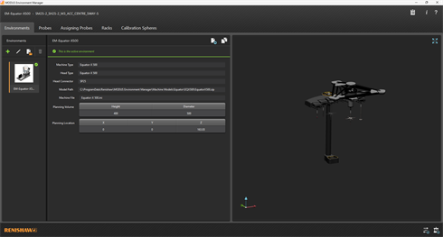

MODUS IM DMIS Environment manager
MODUS™ IM Environment Manager application
The MODUS IM Environment Manager application creates an accurate virtual environment to mimic real-life setups, including the measurement probe configurations available, how those probes are stored in the racks, the styli, calibration equipment and other required information.

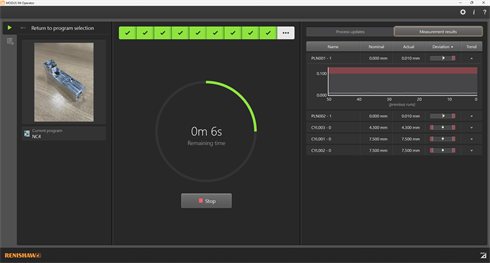

MODUS IM DMIS Operator - Program running
MODUS™ IM Operator application
The MODUS IM Operator application provides an intuitive interface for operators to execute programs, displaying only information relevant for that purpose. Additionally, the generic interface links to helpful applications in the MODUS IM platform and displays essential information, such as remaining program runtime, measurement results for the current run and pass/fail status of the previous 10 runs.
