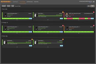

In unattended processes, the status of devices can be monitored remotely. If any errors occur, they will be detected and displayed within the Renishaw Central platform's dashboards or other third party applications. As a result, an appropriate operator can be deployed to resolve the fault.

Live data can be displayed, sorted, filtered, and analysed within the easy-to-use dashboards.

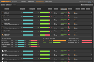

Since integrating the platform, we have found that two key issues are responsible for 82% of automation stoppages. By converting this actionable data into remedial actions, we have been able to increase weekly machine availability by 79 hours.
