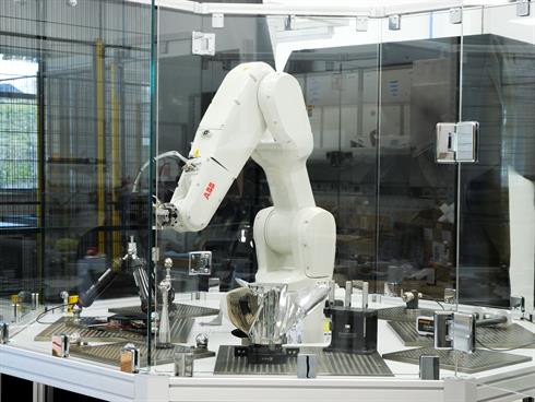

RCS products including the RCS L-90, RCS T-90 and RCS P-series on a ABB six-axis robot as part of an octagonal demo cell
