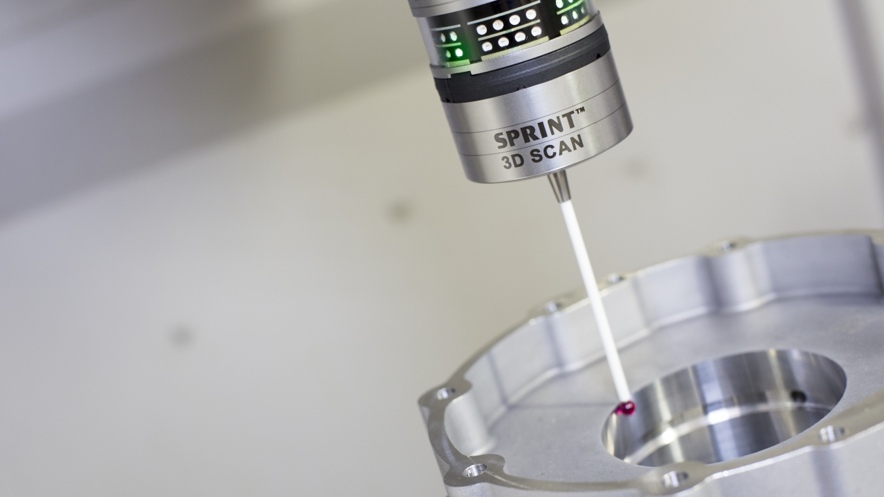

SupaScan is an easy-to-use machine tool probing system capable of workpiece scanning and exceptionally fast point measurement.
Driven by SPRINT™ technology, SupaScan is the fastest on-machine probing solution for workpiece set-up. Surface condition and form can also be monitored – greatly enhancing your on-machine inspection capability.
Reduce scrap, enhance productivity and increase profits – SupaScan can keep complex machining processes under control.

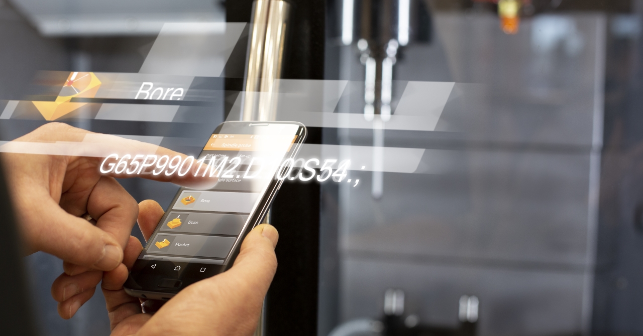

Inspection Plus can be programmed manually using G-code, or via the GoProbe and Set and Inspect programming apps.

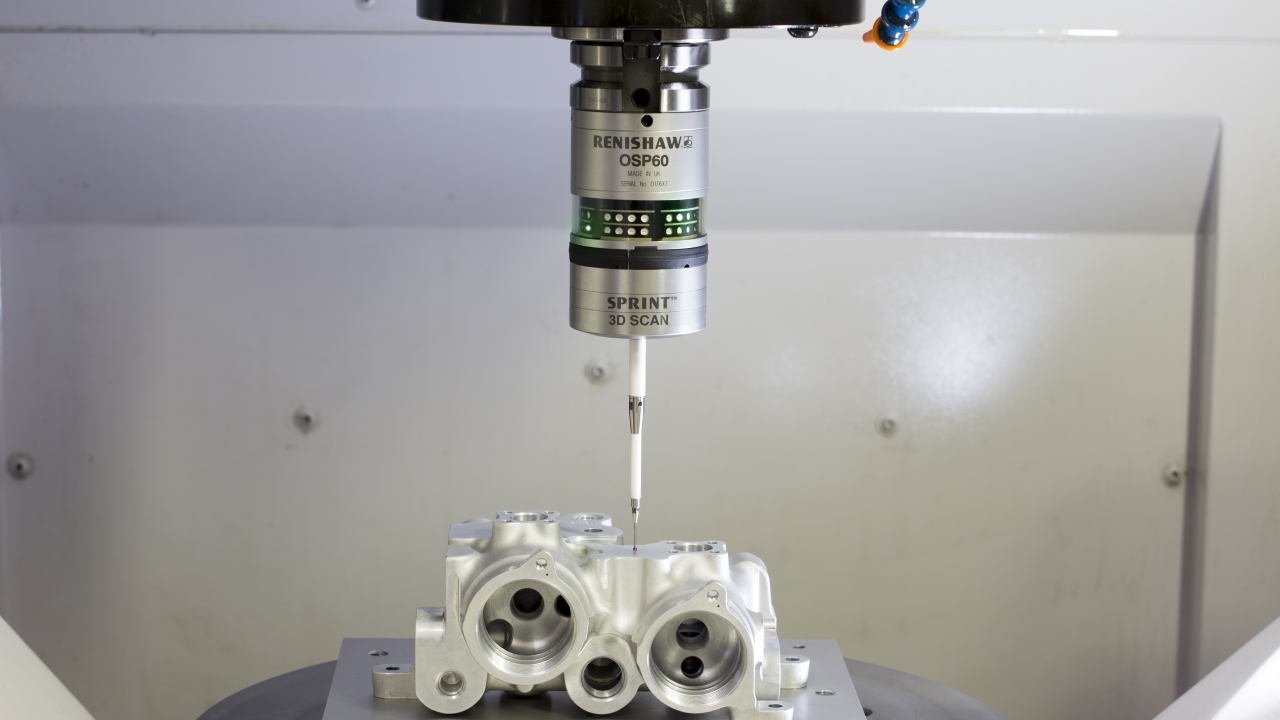

Super-fast scanning
SupaScan provides up to 60% inspection cycle time reduction on simple prismatic components when compared with touch-trigger measurement.
Workpiece set-up cycles return accurate measurement results even when performed at up to rapid (G0) feedrates – as fast as it is physically possible for the probe to traverse the surface of the workpiece.

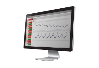

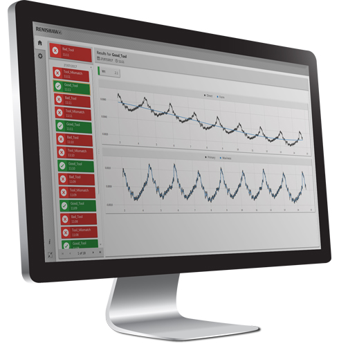

View live surface traces using the Surface Reporter app
A complementary application – Surface Reporter – provides a real-time, graphical representation of the workpiece surface condition.
Colour-coding clearly indicates to the operator whether the component surface is in or out of tolerance.

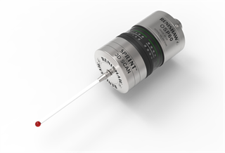

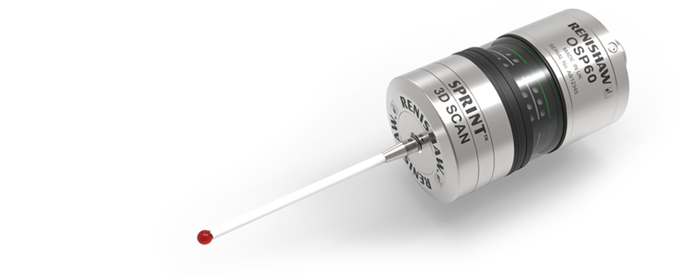

OSP60 inspection probe
An analogue scanning probe for machine tools, capable of scanning and touch measurements.

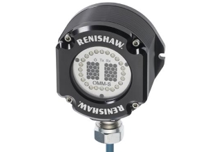

OMM-S receiver
An optical receiver specific to the OSP60 inspection probe.

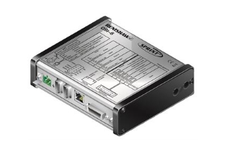

OSI-S interface
An optical interface providing input/output communication with the machine tool.

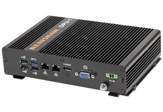

DPU-1 data processing unit
Processes and stores scanned measurement data. Saves results into machine variables (via the CNC API) for use in downstream processes.

Surface Reporter
An app displaying surface condition trace, part pass/fail and Wt value. Resides on a device running Microsoft® Windows connected to the machine.
