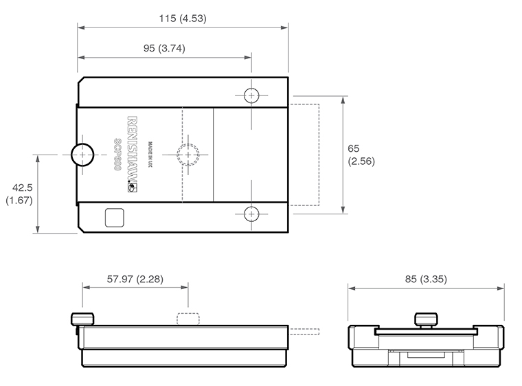

Dimensions
SCP600 dimensions
NOTE: Dimensions in mm (in).

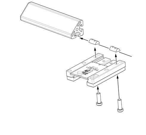

The SCP600 fixes to the MRS / MRS2 rail as shown below:
Fitting SCP600 to MRS2
