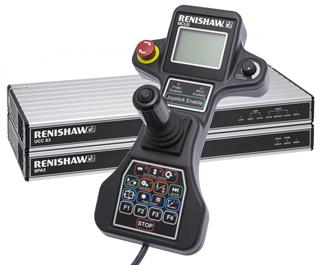

UCC S3 and SPA3 with MCU
Renishaw's UCC flexible controllers provide advanced touch-trigger and scanning algorithms, which allow fast, accurate, adaptive part measurement.
The UCC is a critical component of Renishaw's revolutionary 5-axis scanning technology, using synchronised motion of machine and head axes to minimise the dynamic errors of CMM motion at ultra-high scanning speeds
Combined with a Renishaw servo power amplifier Renishaw's UCC universal CMM controller enables precise motion control of up to five axes of simultaneous motion on machines of all sizes and also supports rotary tables. It also provides a single-box interface to all Renishaw sensors and can gather surface data at up to 4,000 points per second.
