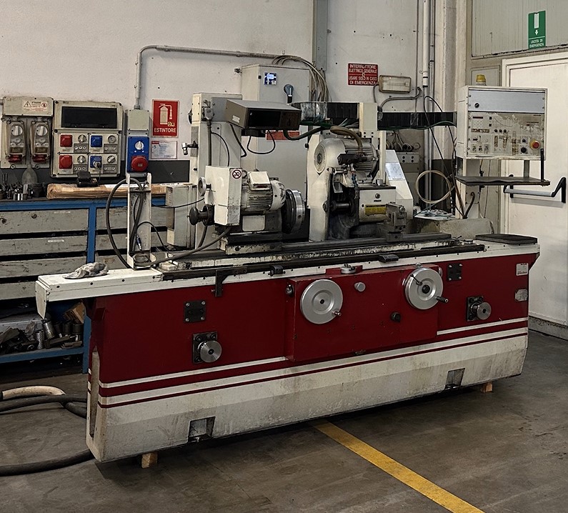

Euro Tecno Tool s.r.l., a customer of R.A.M. Service, owned an old Studer S30 grinding machine that faced production limitations with its outdated electronic system. “The Studer S30 is an old but great grinding machine,” Mr Monica says.
The axes were manually operated, which led to suboptimal precision and reliability, restricting the machine's capacity to meet the high-quality standards required for metal packaging. The machine's control panel had also deteriorated over 30 years of use and needed modernising.
Additionally, the customer needed to grind a specific shape that the machine was not originally designed to support.

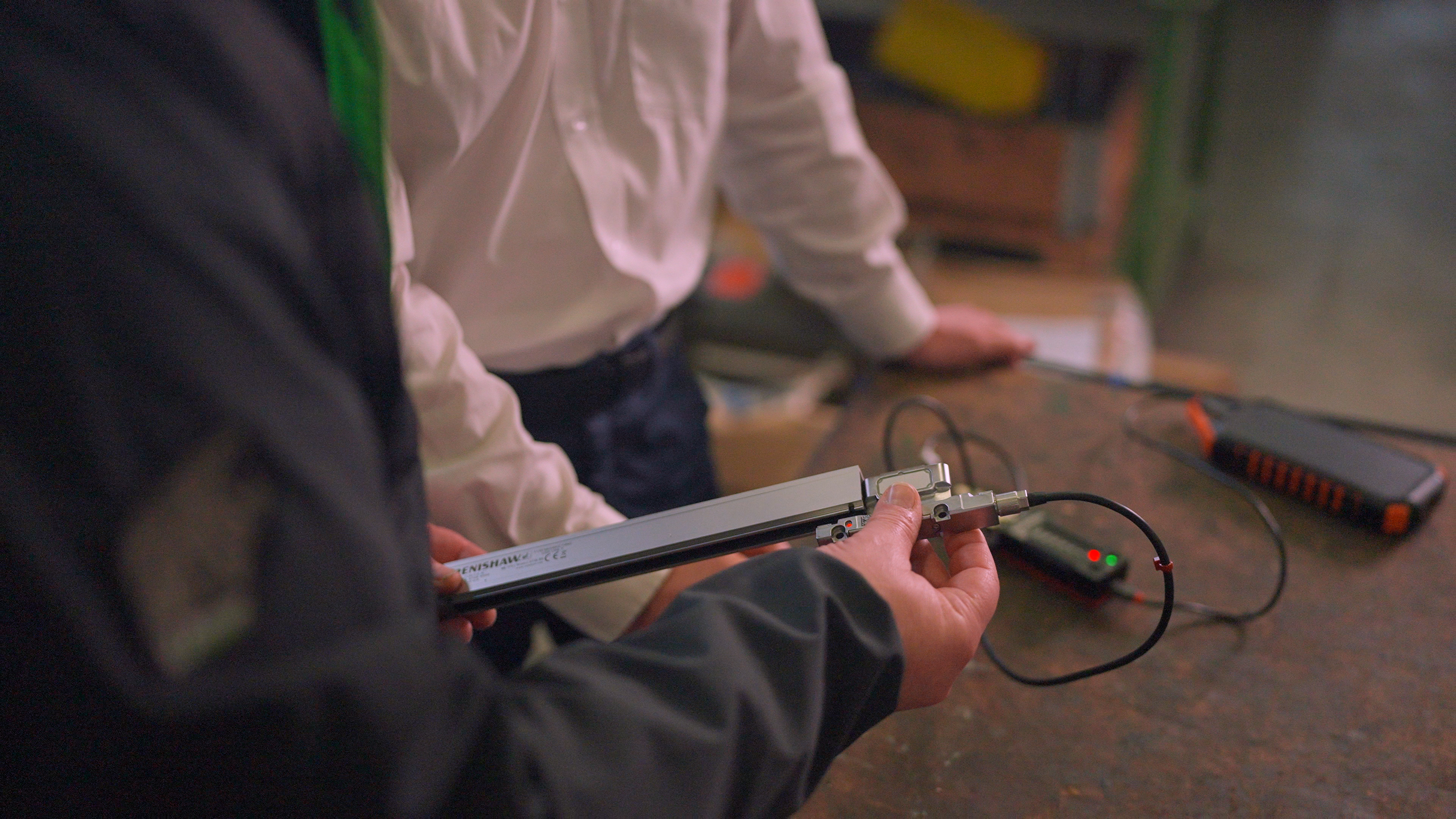

FORTiS scales were chosen for their ease of installation and set-up, as well as their accuracy. R.A.M. Service technicians were able to install them quickly and precisely, even if they were previously unfamiliar with the scales. The ADTa-100 Advanced Diagnostic Tool streamlines the installation process, using multi-colour LED indicators to guide and verify optimal set-up.

The installation of the FORTiS encoder went very well. It was easy, especially when using the ADTa-100 diagnostic tool to adjust the readhead. This diagnostic tool provides a signal health check of the encoder to confirm that set-up has been successful."
RAM Service - old Studer grinding machineStuder S30 grinding machine prior to retrofitting

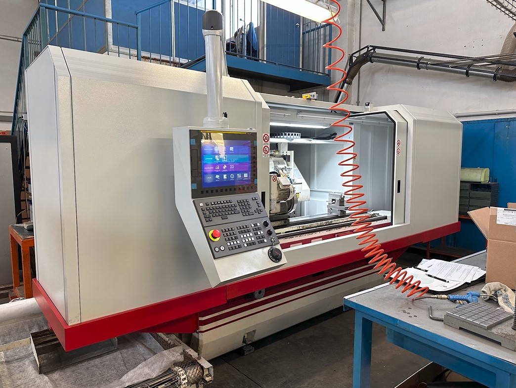

R.A.M. Service redesigned the Studer machine's electrical and mechanical parts, installing a new FANUC CNC system and the FORTiS scales. The result was a significant improvement in precision and the ability to machine complex shapes, meeting the client's needs effectively.

As Mr Corradini, R.A.M Service Technician, says: “A Renishaw engineer came down for a day to help us resolve an installation issue on the Studer machine. We used a computer application [ADT View] to see the encoder reading in real-time to many decimal places, which enabled us to make the correct adjustments. Our first installation of a FORTiS encoder went very well; it was intuitive, fast, and manageable.”

RAM Service - retrofitted Studer S30
Retrofitted Studer S30 machine
