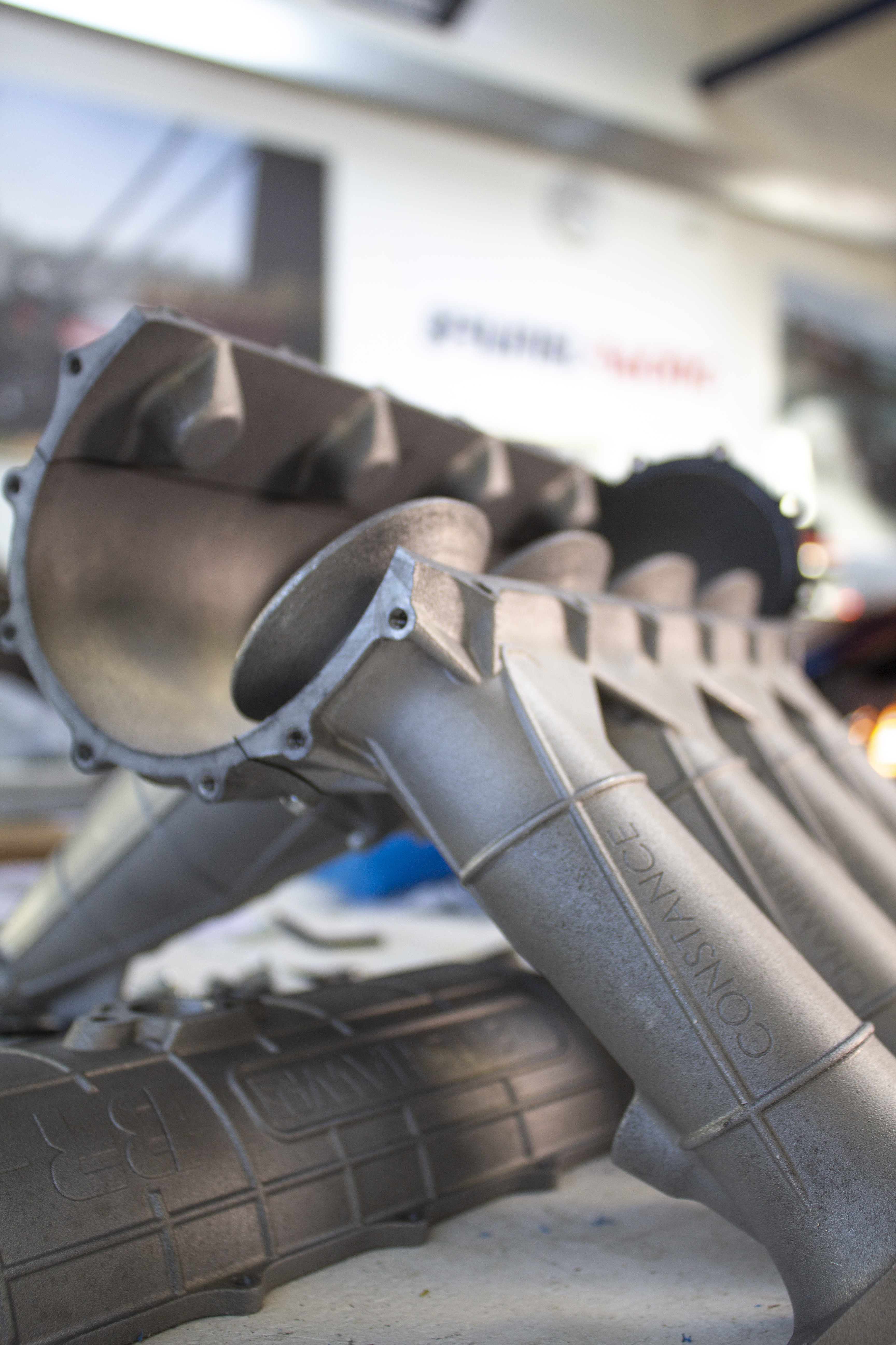

Global engineering technologies company, Renishaw, is supporting the Brunel University London race team in its 20th year participating in the Formula Student (FS) competition. Renishaw is contributing its metal additive manufacturing (AM) expertise to help Brunel Racing create a manifold part for the team's BR-XX car, which will be used to compete at FS-UK in Silverstone and FS-ATA in Italy in July.
Formula Student, which has existed for over 20 years, is Europe's most established educational motorsport competition, run in the UK by the Institution of Mechanical Engineers (IMechE). Prior to working with Renishaw, the Brunel Racing team had produced carbon fibre and aluminium fabricated manifolds, but this method had limitations due to the design geometry. This year, the team worked on a more ambitious design including additional features such as dual stage fuel injection and improved port matching between exhaust manifold and the engine to increase efficiency.
Brunel Racing provided Renishaw with the original design geometry for the manifold part and then worked with the company to optimise the part for production on its multi-laser RenAM 500Q AM system. This included splitting the part into smaller assemblies and looking at how to eliminate overhangs where possible.
“Renishaw's expertise and advice on how to design a part for the additive manufacturing process was invaluable,” explained Matthew Crouch, a Mechanical Engineering student and one of the managers of theBrunel Racing team. “To design for AM, overhangs could not be over 55° from the vertical axis on both overhangs and each part requires smooth transitions of cross sectional thickness.”
“Additive manufacturing proved itself to be a much more suitable manufacturing method than a traditional approach,” added Crouch. “The final part performs better in the car due to its increased strength and we also had the added benefit of reduced post processing.”
