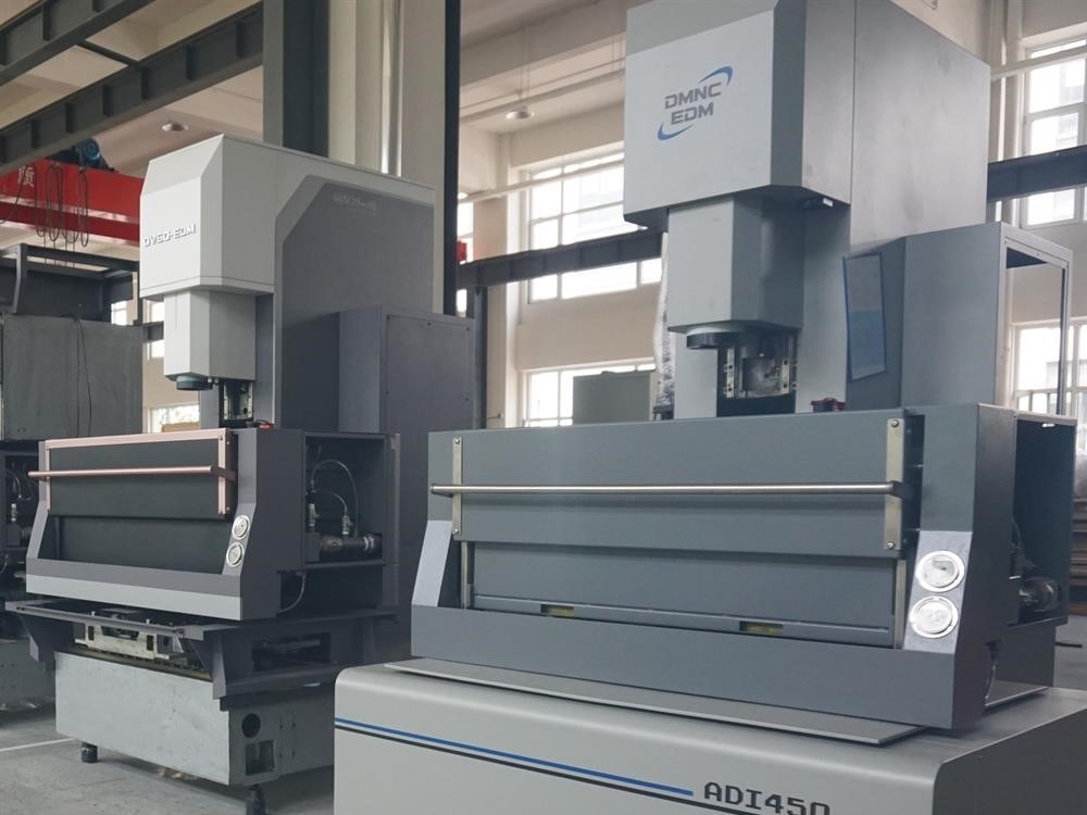

DMNC-EDM is the largest manufacturer of EDM machine tools in China and develops high-end EDM machines for domestic and international customers. It offers five ranges of machines, totalling nearly 50 models, providing core technologies in EDM and an extensive range of EDM equipment for mould manufacturing and the production of complex metal parts. The company is committed to advancing cutting-edge technology and superior quality machine production.
Designed to serve a wide range of applications, DMNC-EDM's ADI / ADV / SF series of high-end EDM machine tools are equipped with high-accuracy A / B / C axes. They enable 6-axis simultaneous machining and synchronised processing combined with industry-leading machining quality, automation, and intelligence.

EDM machines at DMNC factory
DMNC-EDM Beijing facility
