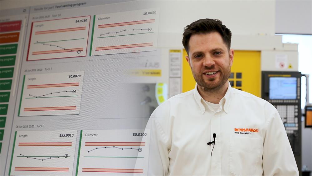

Report on tool length and diameter measurement
As well as workpiece setting and inspection, Renishaw machine tool probing systems can also set the length and diameter of cutting tools on the machine. The latest version of the Reporter app can record tool offset updates and display a graph of how cutting tool length and diameter vary over time. Being able to monitor cutter wear allows operators to see when tools require replacement, preventing scrap caused by using tools with excessive wear, and saving money by avoiding premature tool replacement.
