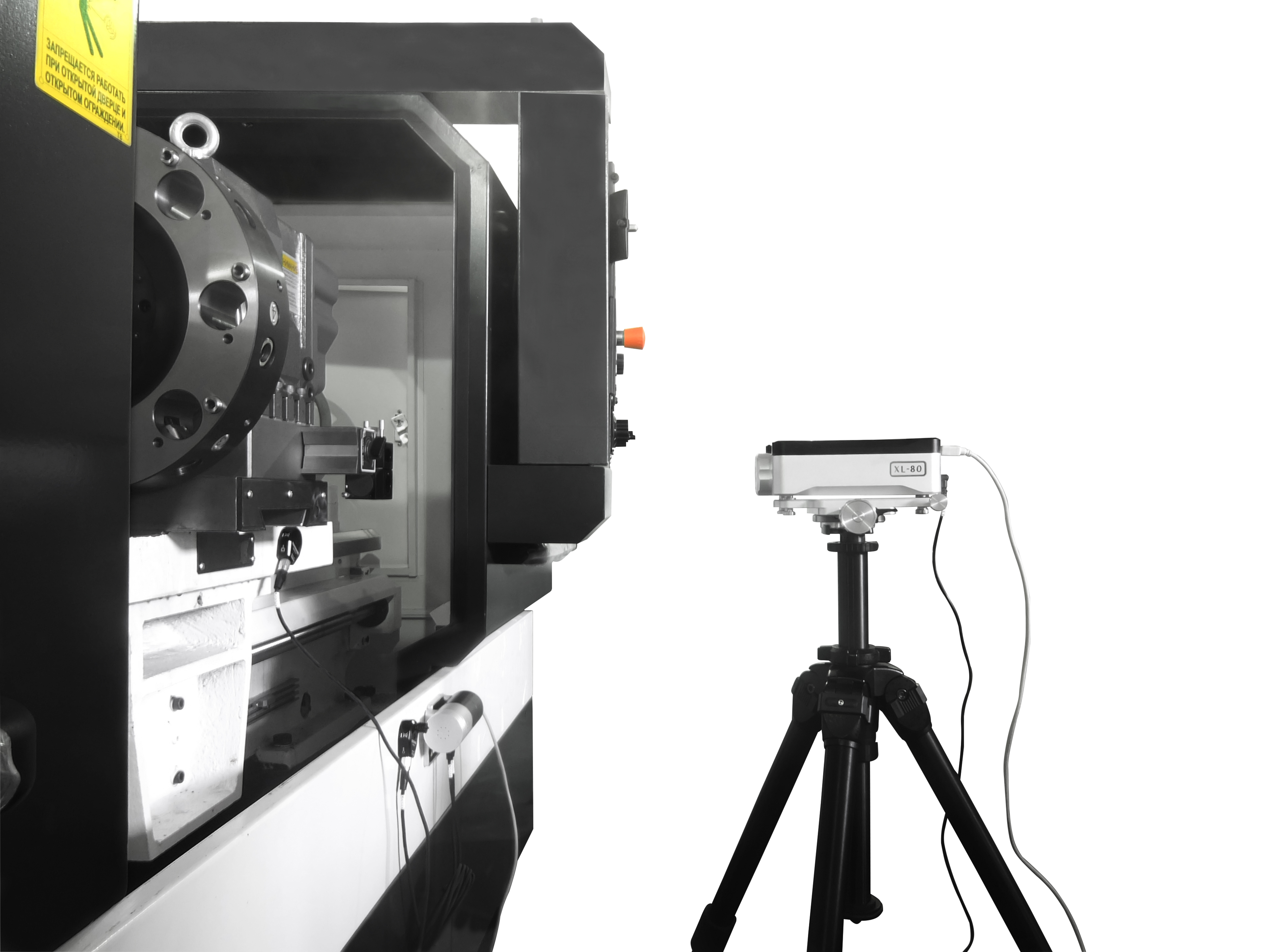

Checking accuracy of movements in machine tools with the XL-80 laser system

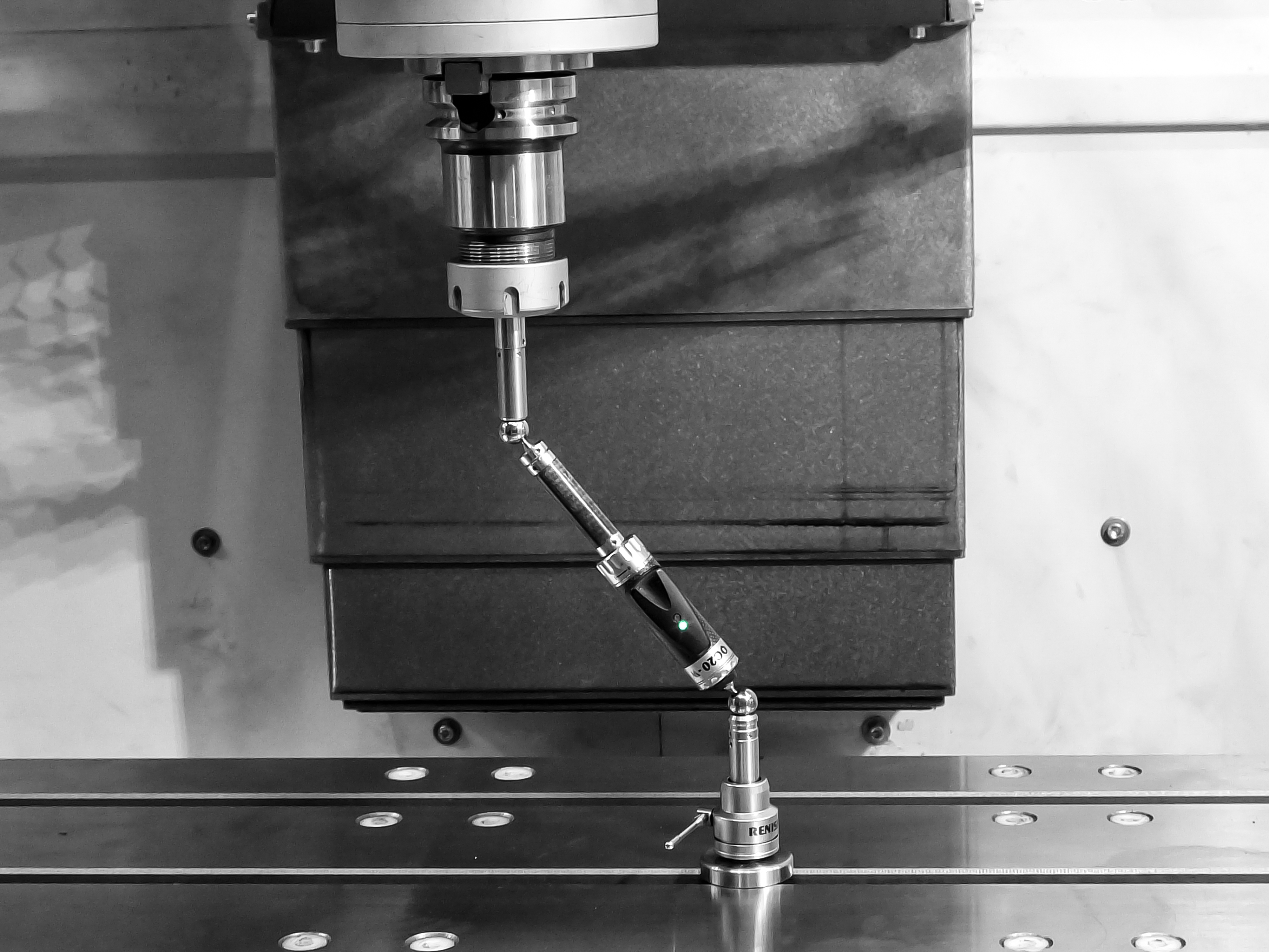

StankoMachComplex uses the QC20-W ballbar to monitor machine tool condition

The first stage in the collaboration between StankoMachComplex and Renishaw was the acquisition of the QC20-W ballbar and the XL-80 laser system. The XL-80 system is used to check the accuracy of movement in machine tools. Testing is carried out on each axis individually and, combined with the QC20-W data, gives a full picture of the condition of the machine tool. Where possible, compensation can be applied to further the performance.

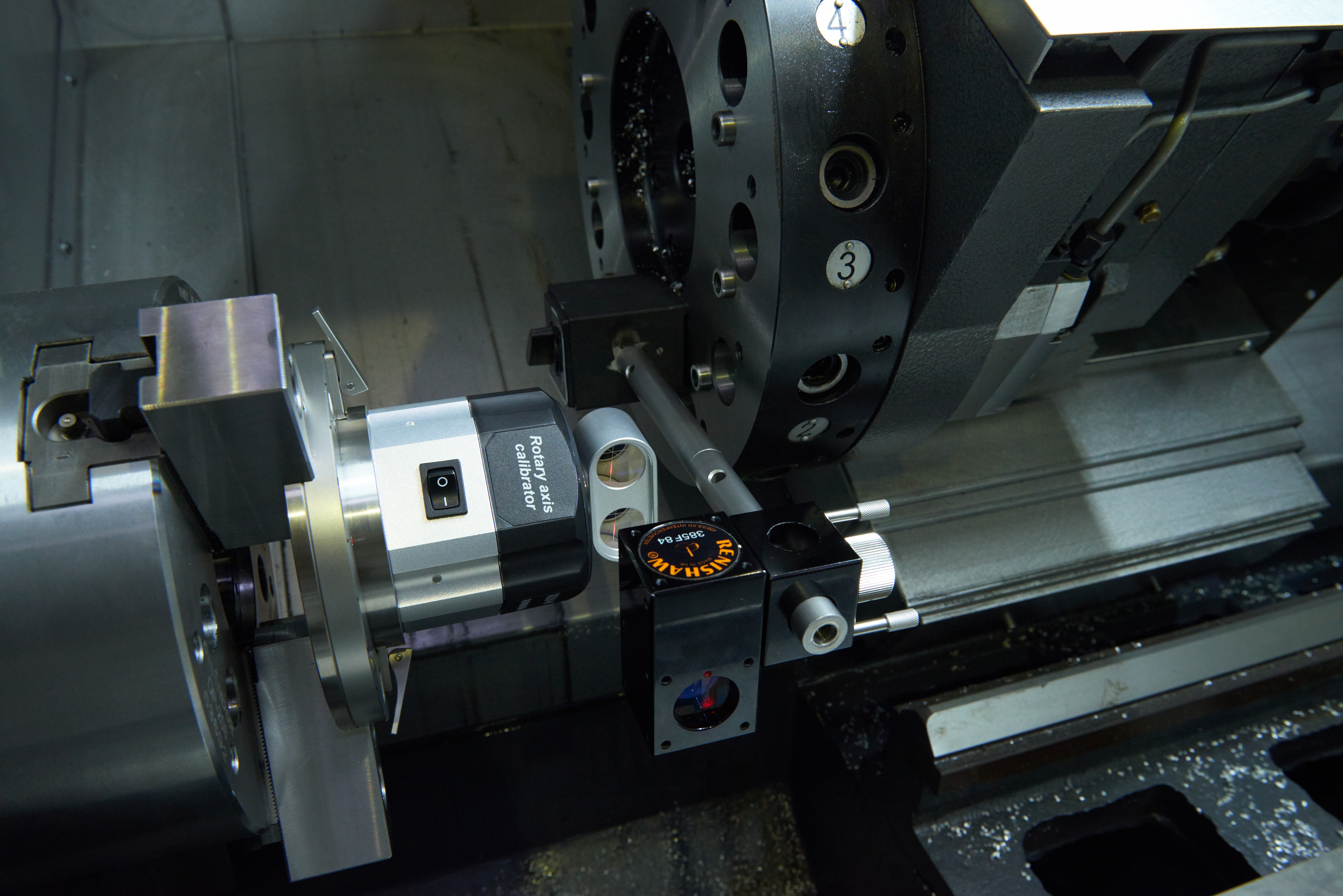

After starting production of mill turn machines with rotary axes, StankoMachComplex purchased a XR20-W rotary axis calibrator which can measure rotary axes up to ± 1 arc second. The system provides a high integrity, non-contact reference measurement, remote from the axis under test. The XR20-W has the flexibility to be mounted on or off the centre of the machine's rotary axis using Renishaw's Off axis rotary software.

Calibration on a machine tool with the XR20-W rotary axis calibrator
Calibration on a machine tool with the XR20-W rotary axis calibrator.
