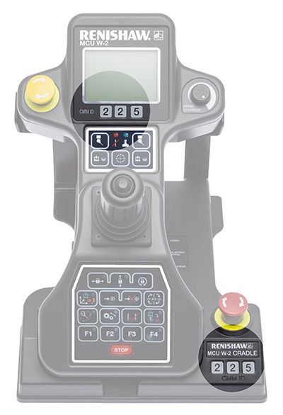

The use of the ID labels
MCU W-2 labels should be used to match the joystick with its paired MCU W-2 cradle. They are intended to avoid confusion if multiple MCU W-2 systems are operating in the same area. Ensure that the ID labels are stuck to both the MCU W-2 joystick and cradle. Ensure that the ID labels are updated if an MCU W-2 joystick is paired with a new cradle.
MCU W-2 ID labels
