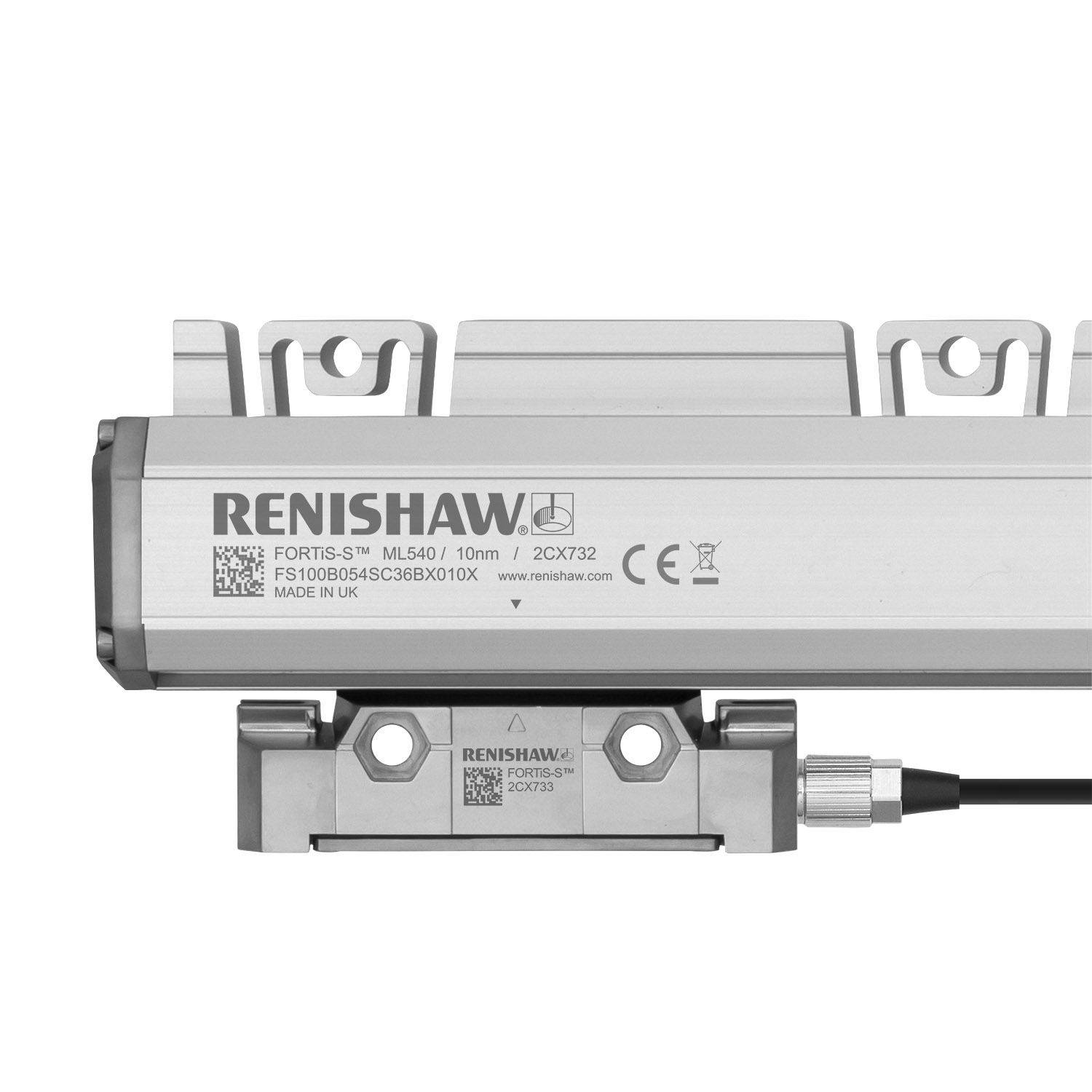

The FORTiS design is built upon industry-proven RESOLUTE™ encoder technology and provides high resistance to the ingress of liquids and solid debris contaminants. It features an extruded enclosure with longitudinally attached interlocking lip seals and sealed end caps. The readhead body is joined to a sealed optical unit by a blade, which travels through the lip seals along the length of the encoder. Linear axis movement causes the readhead and optics to traverse the encoder's absolute scale (which is fixed to the inside of the enclosure), without mechanical contact.
Customers can choose from two different extrusion profiles to suit their space requirements. The FORTiS-S™ linear encoder is the standard-sized encoder, available with measuring lengths from 140 mm to 3040 mm and is installed directly to a machined surface via flexure holes in the extrusion's body. The FORTiS-N™ encoder, available with measuring lengths from 70 mm to 2040 mm, features a narrower cross-section extrusion and a more compact readhead to enable installations in confined spaces. This model can be mounted directly to a machined surface via two end cap mounting holes or a mounting spar for greater rigidity.

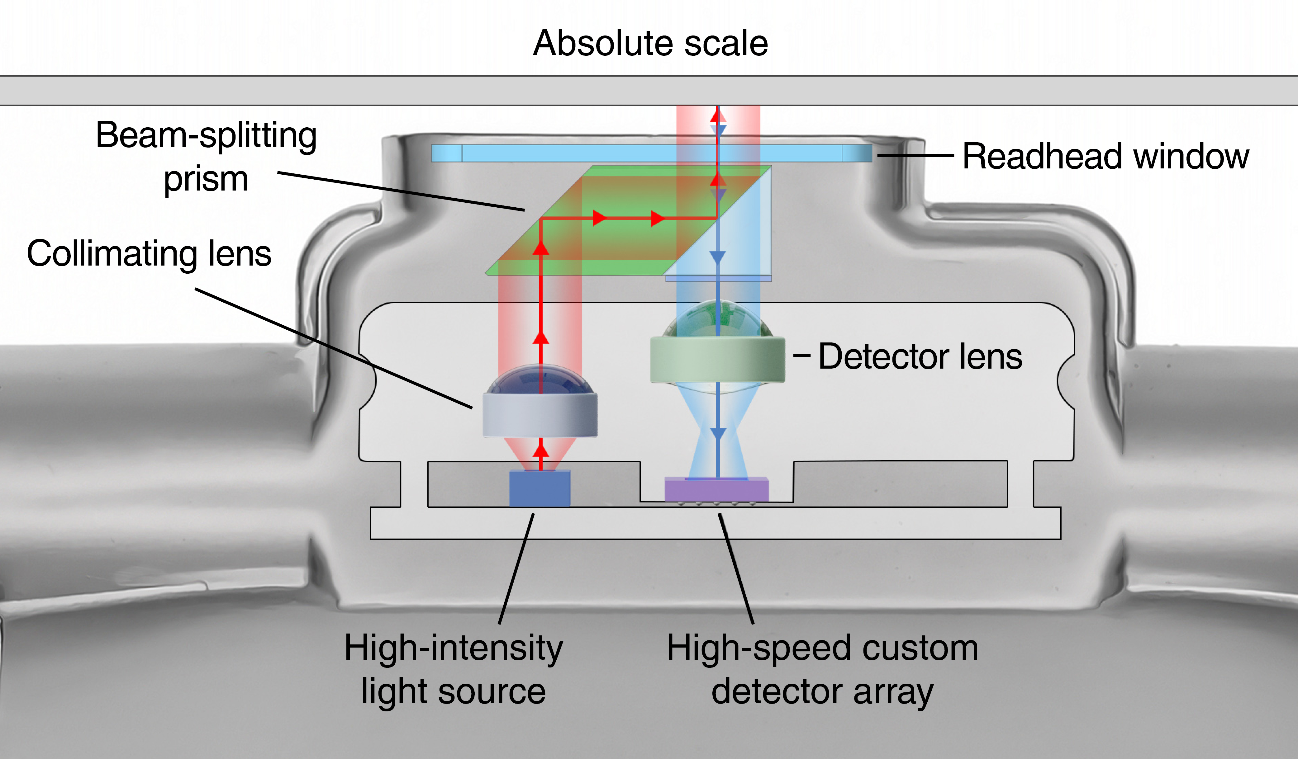

In addition to its extruded enclosure, FORTiS encoders are also protected against contamination by a further level of sealing: the readhead optical unit (which runs inside the enclosure) is itself sealed to IP67 to prevent contamination by liquids, swarf and other debris. Moreover, improved sealing of the FORTiS encoder enclosure reduces air leakage from the air purge system, resulting in lower operating costs and greater system longevity.

For enhanced functionality, installers can connect the Advanced Diagnostic Tool, ADTa-100, via a standard USB connector, to a PC running Renishaw's ADT View software. This provides a user-friendly graphical interface of advanced diagnostic information, including key encoder performance parameters such as signal strength along the axis length. A permanent record of installation data can be saved providing confidence to both machine builders and users.
