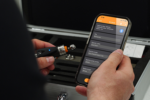

A hand holding mobile device displaying set-up screen of CARTO Ballbar Connect app and other hand holding QC20 ballbar
CARTO Ballbar Connect is Renishaw's first smartphone app for the QC20 ballbar, designed for swift and intuitive testing.
  • Macro-based program; offers a single-line machine instruction to configure and run a ballbar test.
  • Test sequence; 3D Check test runs a quick, static performance check on machine tools.
  • Streamlined ballbar test; reduces measurement time and required user experience.
