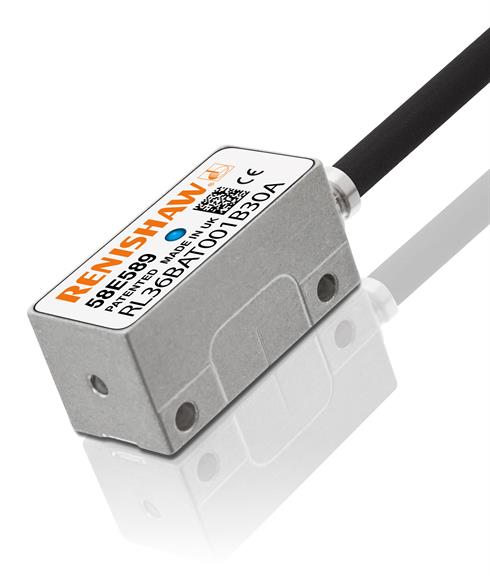

RESOLUTE™ encoder series
The RESOLUTE series is a true-absolute fine-pitched optical encoder system that has excellent dirt immunity, and an impressive specification that breaks new ground in position feedback. It is the world's first absolute encoder capable of 1 nm resolution up to 100 m/s for linear systems, and 32-bit resolution up to 36 000 rev/min for rotary systems. Ultra low Sub-Divisional Error and jitter result in a linear encoder system that outperforms any other encoder in its class.
Additionally, it is available in 3 more application-specific variants:

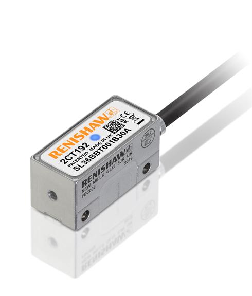

RESOLUTE FS (Functional Safety) is certified to SIL2 and PLd for Functional Safety applications.
