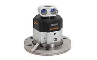

XL-80 laser interferometer system for machine calibration
Easily achieve high-performance measurement and calibration accuracy with the Renishaw XL-80 laser interferometer system, the preferred solution for motion systems, including co-ordinate measuring machines (CMMs) and machine tools.
What is a laser interferometer?
A laser interferometer is a measurement device used to assess and enhance machine performance. It produces an extremely stable laser beam that helps to detect issues in motion systems before they affect production. Unlike laser tracker systems, the XL-80 laser interferometer independently measures geometric errors.
Readings can be taken at up to 50 kHz, with a maximum linear measurement speed of 4 m/s and a linear resolution of 1 nm, even at maximum speed. All measurement options, not limited to linear, rely on interferometric measurements. This ensures utmost confidence in the recorded data's accuracy.

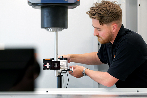

Engineer using the XL-80 laser to test and calibrate a motion stage

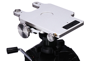

XL-80 Tripod stage
System mounting
A wide range of mounting and staging accessories are available for easy set-up and operation of the XL-80 laser system. From lightweight and adjustable tripods to a tripod stage and magnetic bases, as well as extensive fixturing products, we have the accessories you need.

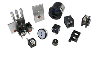

XL-80 optical accessories
Measurement optics
An extensive range of optics kits and accessories allows for the precise measurement of linear displacement, pitch, yaw, horizontal and vertical straightness along any axis. Additional optics kits are available for measurement of surface flatness and squareness.

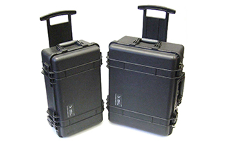

XL-80 system cases upright
Secure transport
Built for security and convenience, Renishaw's range of rugged cases are lightweight and easily transportable. Meticulously designed to complement different system configurations, you can store your XL-80 laser system with confidence.

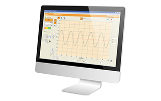

PC monitor displaying screen of QuickView software
QuickViewXL™ software
QuickViewXL™ software is the ideal tool for research and development or on-the-spot analysis. It enables quick and easy investigation, review and characterisation of motion systems. The simple graphical interface allows flexible operation, removing the need for predefined measurement targets and sequences.
