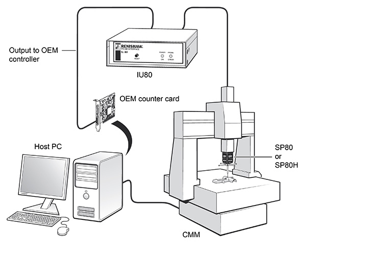

System interconnection and electrical integration
SP80 can be integrated in the following ways:
- Direct integration with Renishaw's UCC S3 controller (this requires the use of a UCC PI 80 interface)
- Using Renishaw's CC6 PCI counter card together with Renishaw's IU80 interpolator unit
- OEM designed counter card used with Renishaw's IU80 interpolator unit
- OEM designed counter card and interpolator unit
