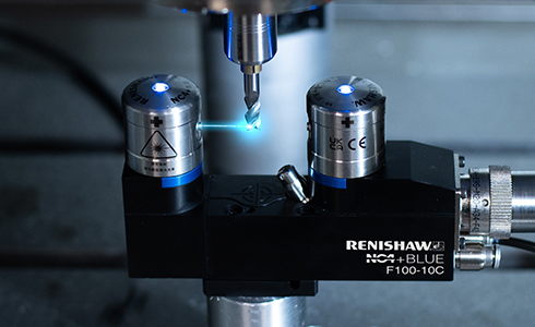

New to the range are the NC4+ Blue F100 systems. The F100 models achieve repeatability as low as 0.1 µm 2σ and can detect tool defects as small as 5 microns, making them our best performing units.
The F100 also introduces enhanced efficiency, with an optimised airflow design that reduces barrier air consumption by over 50%. This improvement helps lower energy usage and operational costs while maintaining exceptional measurement performance.
NC4+ Blue F100 measuring a tool on machine with laser beam
