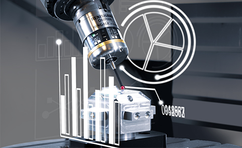

High-accuracy touch probes for CNC machines
With unbeatable 3D measurement capability, our family of high-accuracy touch probes for CNC machines offer an exceptional performance. With ultra-low trigger forces and high repeatability, high-accuracy probes are ideal for setting and inspecting complex workpieces.
Ultimate 5-axis machine tool measurement
Engineered for over a decade, our high-accuracy touch probes provide unparalleled performance and capabilities. Thanks to the innovative strain gauge sensors, probes with patented RENGAGE™ technology provide a competitive advantage.
Suitable for a wide range of applications, they address the 3D performance limitations of many alternative probe designs. Use to set workpieces, control machining processes, or to inspect a workpiece after machining has completed.
  • Superior 3D accuracy - Unrivalled submicron performance when measuring complex 3D shapes and contours.
  • Ultra-low trigger force - Helps eliminate surface and form damage when inspecting delicate workpieces.
  • Robustly engineered - Providing reliable measurement and long service life, even in the harshest environments.
  • High-accuracy measurement - Inspect complex parts and difficult-to-reach features, even with very small, long, or custom styli.

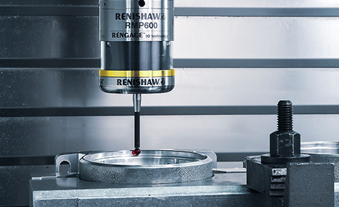

Radio transmission probes
RMP400 probing bore
RMP400
RMP600 bore probing
RMP600
The ultra-compact RMP400 measures just 40 mm in diameter, whilst the compact RMP600 measures 63 mm. Both probes offer an exceptionally reliable probing solution – designed for larger machines or installations where the spindle is not within line-of-sight of the receiver.
  • RENGAGE™ technology combined with radio transmission for hassle free probing.
  • Avoids interference and dead spots with frequency-hopping spread spectrum (FHSS) technology.
  • Operating range of up to 15 m.
  • Trusted choice for many customers.
  • Unidirectional repeatability of 0.25 µm 2σ.
