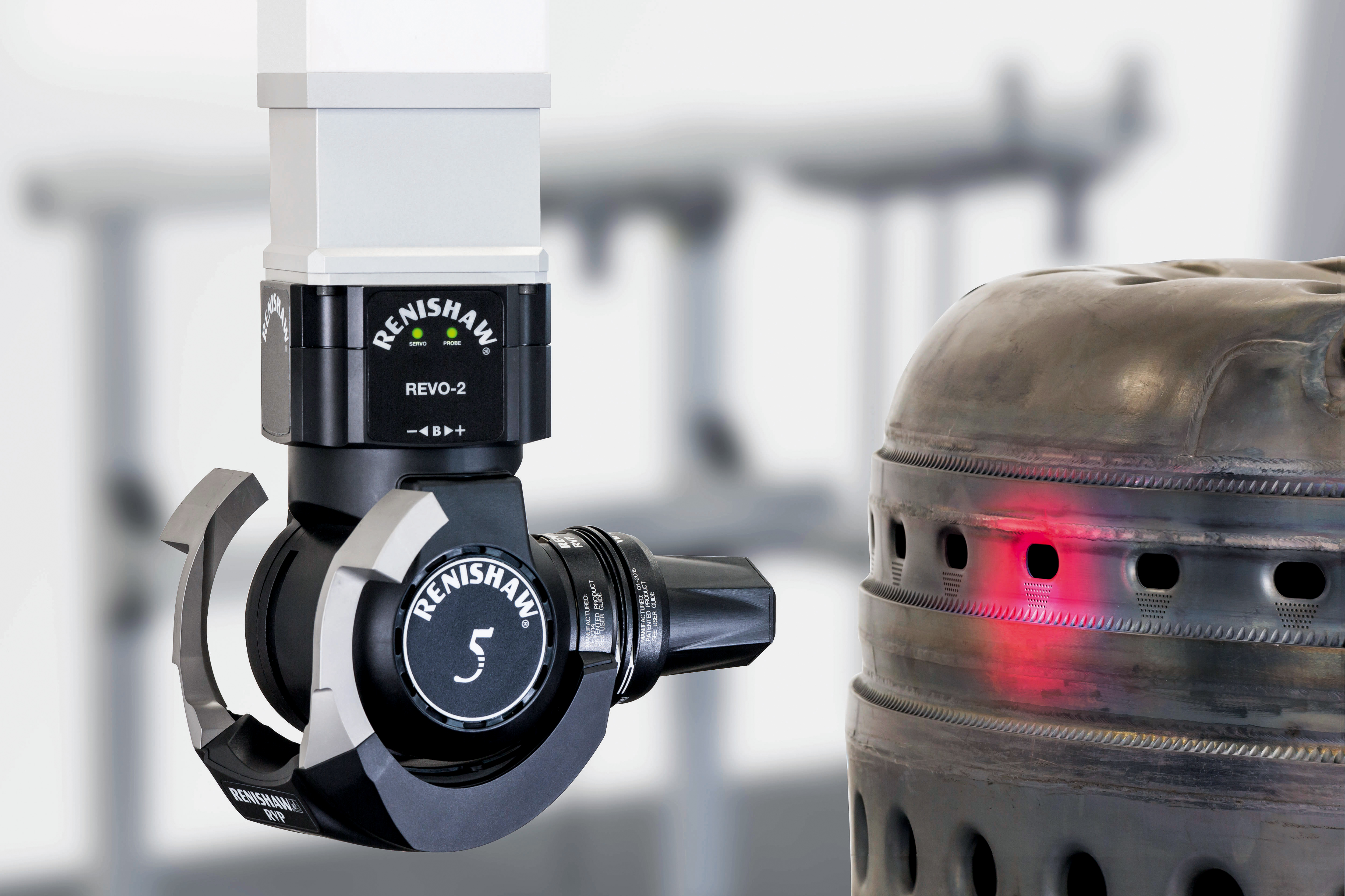

Renishaw expands the capabilities of its REVO® system with a new sensor and enhancements to the existing range of probes
Renishaw's REVO 5-axis measurement system delivers high-performance scanning, non-contact inspection and surface finish analysis on a single CMM. When used in conjunction with a low cost changer, the REVO system's removable probes provide added system flexibility, enabling manufacturers to carry out more measurements on the same machine.
At EMO 2021, Renishaw is promoting its flexible REVO 5-axis CMM inspection technologies, including a brand new sensor, and enhancements and updates to its existing range of probes.
The new RUP1 ultrasonic probe for use with the REVO system adds automated ultrasonic thickness inspection to the system's existing CMM inspection capabilities. Ultrasonic thickness measurement delivers clear advantages over traditional tactile probing techniques for parts where access to internal features is challenging. Aircraft landing gear parts, power generation drive shafts, and hollow aerospace blades are all parts where the RUP1 probe will be of benefit.
EMO visitors can see a demonstration of the RUP1 system measuring the wall thickness of a tubular aerospace component at the Renishaw stand (hall 5, stand C14).
Also for use with the REVO 5-axis measurement system, Renishaw is extending the range of modules for its renowned SFP2 sensor for automated surface finish inspection.
New additions include a specialised stylus for groove measurement, such as the grooves in engine cylinder bores prior to a plasma coating process. Another module is characterised by its large elongated radius skid (125 mm), which enables scanning with cut-off values above 0.8 mm, making it more tolerant of measuring parts that may not be perfectly clean, while still being compliant with international standards.
Enhancements to the REVO system's other range of sensors include the addition of an angle change mirror (ACM) for use with the REVO vision probe (RVP) for non-contact inspection applications. The ACM accessory enhances access for the RVP system with the help of a precision mirror, which rotates the field of view through 90°, allowing vision inspection of bore surfaces and other features previously inaccessible to RVP.
The RVP probe and ACM will be on display at EMO Milano 2021 to showcase the speed, flexibility and ease of use of Renishaw's automated multi-sensor technology on a single CMM. Visitors to the Renishaw stand can watch RVP inspecting an electric vehicle (EV) motor stator.
