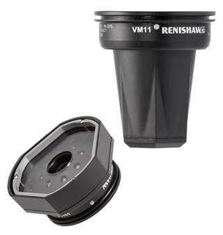

VM10 and VM11-2 RVP modules
RVP is the probe component of the system that houses a 1.3 megapixel global shutter CMOS sensor and digital signal processor. The CMOS sensor inside the probe captures large amounts of light even with short exposure times; leading to quicker image capture and faster measurement times.
The RVP system features two vision modules that provide unique capability. Typical applications for the VM10 module include the inspection of thin sheet metal parts like combustor casings for aerospace engines, whereas the VM11-2 module will allow the inspection of laser-drilled cooling holes in aerospace engine blades and components.
