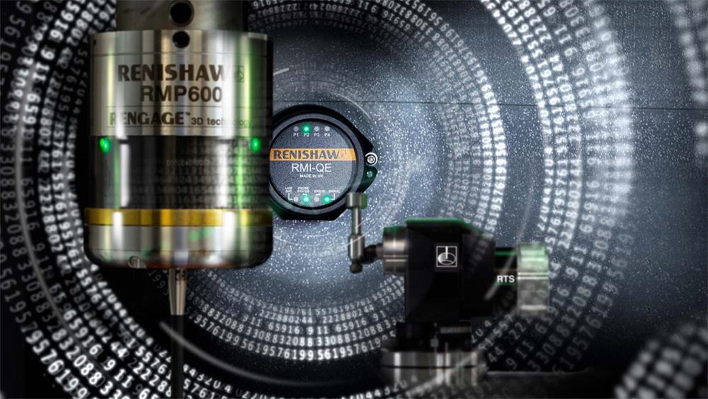

Compact spindle probe with radio signal transmission
The RMP60 is a compact spindle probe with radio signal transmission which offers automated part set-up and in-cycle gauging on machining centres, including 5-axis machines.
The traditional Renishaw kinematic resistive probe mechanism in the RMP60, combined with a unique and secure frequency hopping transmission protocol, make it ideal for the modern machine shop where harsh environments mean line-of-sight between probe and interface is not always possible.

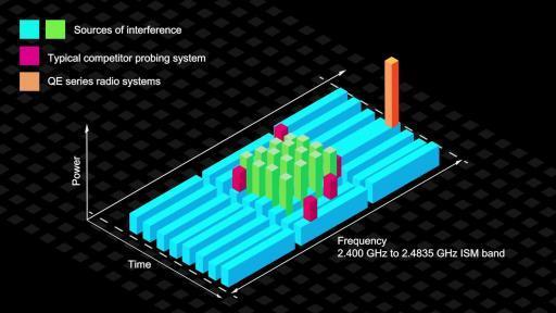

- Secure frequency hopping spread spectrum (FHSS).
- Globally recognised 2.4 GHz waveband – compliant with radio regulations in all major markets.

During the planning stage of the project it occurred to us that the new machine would be located close to the welding area and that there was a very real possibility of signal interference, so we needed a system that could cope with the conditions. The Renishaw RMP60 is the first inspection probe to use frequency hopping spread spectrum (FHSS) data transmission.
