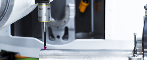

Designed for grinding applications
Performance in harsh environments
A double diaphragm sealing allows the MP250 probe to function in abrasive particle-laden environments often found in grinding machines – even in these conditions, the probe maintains exceptionally reliable measurement over a long service life.

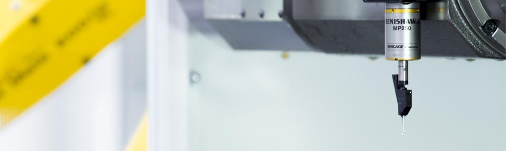

Compact design
The MP250 is only 25 mm in diameter – being so small in size allows for better access in machines where space is at a premium.

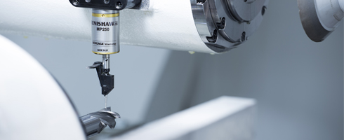

Withstand machine vibration
Superior performance is sustained even when the probe is subjected to high levels of vibration – often experienced during turning and grinding operations. If machine vibration is a problem, the probe can be switched to a more vibration-resistant configuration.

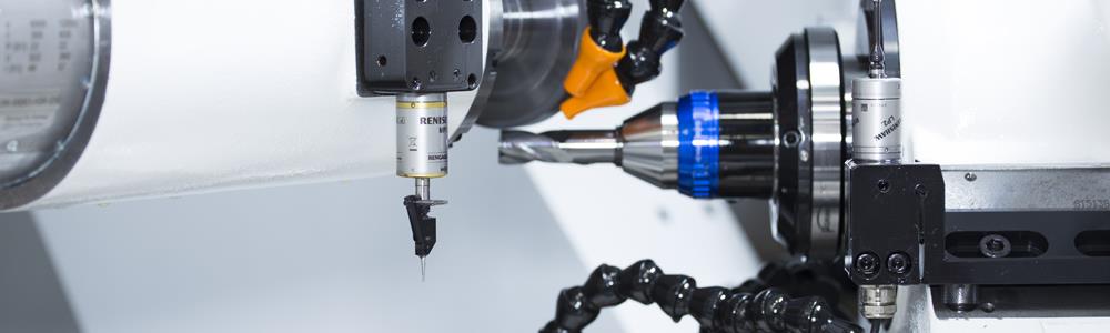

Use with custom styli
Long and heavy custom styli – often required for tool and cutter measurement on grinding machines – can be used with the MP250. RENGAGE™ technology allows the probe to maintain outstanding accuracy – ensuring low pre-travel variation, even when used with large styli.

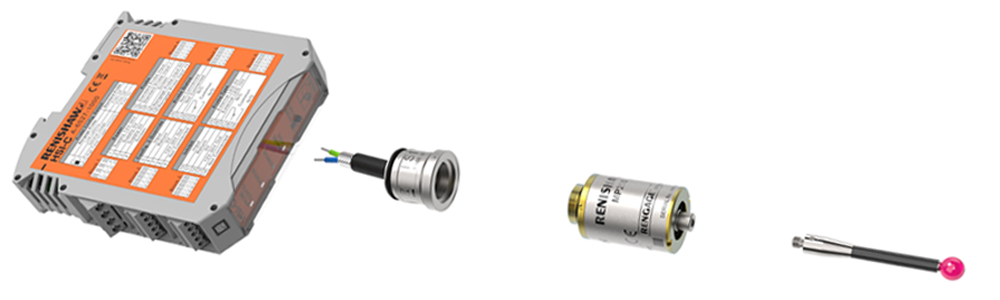

System components
HSI-C interface
A hard-wired transmission interface that conveys and processes signals between the inspection probe and the CNC machine controller. Different probe operating configurations can be selected by a switch on the interface.
FS10 / FS20 socket
A socket that provides a robust mounting position for the inspection probe and a fully screened, hard-wired connection between the inspection probe and the interface.
MP250 inspection probe
A 25 mm diameter touch-trigger inspection probe, equipped with RENGAGE technology for high-accuracy measurement.
Styli
A range of solid high modulus carbon fibre styli has been developed for use specifically with strain gauge probes. These styli are designed to minimise pre-travel variation and improve the accuracy of the probe. Specialised application-specific styli can also be used.
