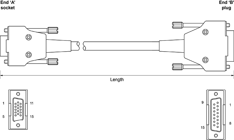

This straight cable has a 15-pin high-density D-type socket at end 'A' and a 15-pin D-type plug at end 'B'. It is used to connect REVO-2 or PH20 to the controller.
Technical drawing:  Technical drawing:  High speed communications cable
Head end
(15-way high-density
'D' socket)
pin number
Colour
Controller end
(15-way 'D' plug)
pin number
1Orange3
2Black2
3Red6
4Grey7
5Brown15
6Orange / black11
7White4
8Clear12
9Green / yellow9
10Pink8
11Green1
12Green / black10
13Blue5
14Violet13
15Yellow14
ShellScreenShell
