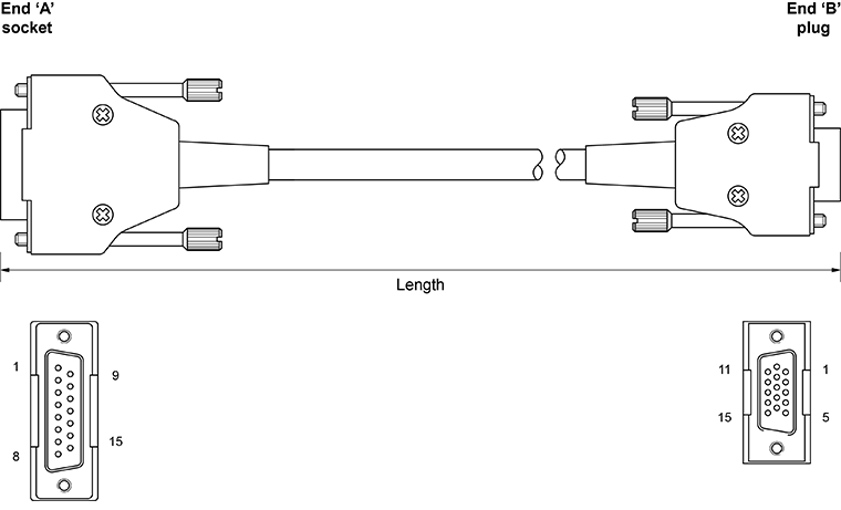

Scale adaptor cable
| Part number | Length |
| A-1333-0183 | 260 mm (10.24 in) |
This straight cable has a 15-pin D-type socket at end 'A' and has a 15-pin high-density D-type plug at end 'B'. This custom product cable is used where scale interpolators are connected or where machine cabling is compatible for its use.
End 'A' and 'B' | Wire | End 'A' and 'B' | Wire |
1 | Red | 9 | Orange |
2 | Blue | 10 | Pink |
3 | Green | 11 | Turquoise |
4 | Yellow | 12 | Grey |
5 | White | 13 | Red / blue |
6 | Black | 14 | Red / green |
7 | Brown | 15 | Red / yellow |
8 | Violet | Shell | Outer screen |
