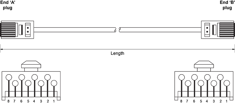

UCC2 to SPA2 6th axis cable
Part numberLength
P-CA82-0013360 mm (14.17 in)
This straight Ethernet cable has RJ45 type plugs that are connected pin-to-pin at each end. Each 6th axis installation requires one of these cables for the additional signal communications between units.
UCC2 to SPA2 communications cable
End 'A' and 'B'
Wire
1
Orange / white
9
Orange
10
Green / white
11
Blue
12
Blue / white
13
Green
14
Brown / white
15
Brown
