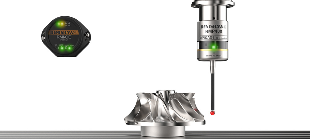

Radio interface
The radio interface uses FHSS technology to convey and process signals between the inspection probe and the CNC machine controller. Both the RMI and RMI-Q can be used with Renishaw radio inspection probes.
RMP400 inspection probe
A 40 mm diameter touch-trigger inspection probe, equipped with RENGAGE™ technology for high-accuracy measurement and FHSS technology for reliable transmission.
