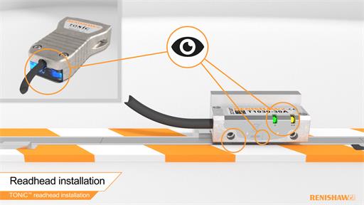

Installation video: How to install the Renishaw TONiC™ super-compact digital encoder readhead (mp4)
Learn how to install the TONiC super-compact digital encoder readhead. Please refer to the relevant TONiC installation guide for more information. The TONiC encoder series is Renishaw’s super-compact, non-contact incremental optical encoder that offers speeds up to 10 m/s and, when combined with the Ti interface, resolutions down to 1 nm for both linear and rotary applications. TONiC systems are quick and simple to install with wide set-up tolerances and calibration at the push of a button. TONiC's dynamic signal processing gives improved signal stability with ultra-low Sub-Divisional Error, high running speeds and compatibility with linear and rotary applications. This makes TONiC suitable for the highest of performance applications where speed and accuracy are crucial. TONiC UHV is available for ultra-high vacuum applications.
