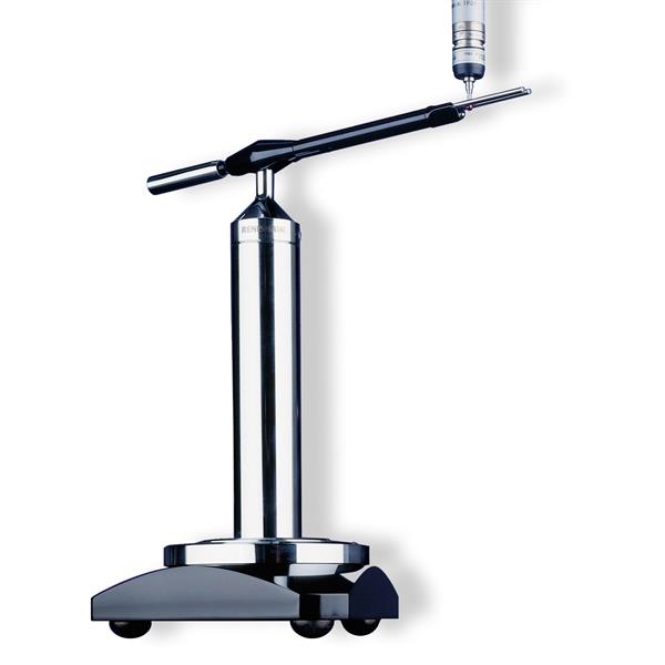

MCG - 523mm single arm kit Product code: A-1007-0155 Machine checking gauge, no headMachine checking gauge.[0B] Machine checking gauge, no head Machine checking gauge. [0B] Price: $3,403.00 All prices are ex sales tax Limited AvailabilityLonger lead times may apply.Contact us for more information. Add to new group Before you begin to add items to your favourites please create your first group: A favourites group name can only be 1-80 alphanumeric characters and must not begin with white space Product sucessfully added to View favourites Processing request Renishaw's Machine Checking Gauge (MCG) provides a simple method of monitoring CMM volumetric accuracy (to ISO 10360-2 standards) at regular intervals between annual service and re-calibration, or after a collision. The results give assurance that measurements taken on the CMM are accurate, or give conclusive proof that servicing or re-calibration work is needed. The process is quick and cost effective, typically taking between 10-20 minutes. A range of pillar heights and arm lengths are available so that volumetric accuracy can be checked on both large and small CMMs. Each MCG is supplied with its own certificate, traceable to UKAS standards. Technical tableArm length (mm)523 Part NumberDescriptionQuantityA-1007-0011MCG 532 mm arm1A-5000-7650MCG stylus1A-1007-0017MCG pivot1A-1007-0018MCG weight1A-1007-0061MCG base plate1M-1007-0024127 mm MCG pillar1M-1007-0025235 mm MCG pillar11.5 mm A/F hexagon key1A-1015-7645MCG small kit box1 Related products $4,166.00 MCG - small CMM checking gauge kit (for CMMs up to 1 m³) $5,223.00 MCG - comprehensive CMM checking gauge kit (for all CMMs) $2,840.00 MCG - 151 mm single arm kit $3,133.00 MCG - 380 mm single arm kit Shopping security Recall your cart
