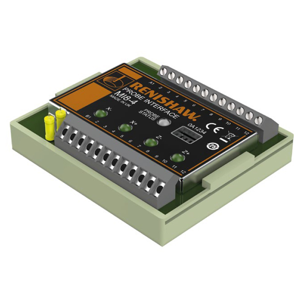

Interface for processing the probe signal from a hard-wired kinematic probe and converting it to the correct format for connection to a controller’s probe input.
The MI 8-4 can also be connected to the 4-wire Fanuc automatic measurement input (XAE, ZAE). Four signals are required from the control to determine which of the four outputs should generate the probe’s signal.
Technical table
Transmission typeHard-wired
Key features and benefits:
• M-code controlled switch between inspection probe and tool setting probe output
• Diagnostic LEDs indicate axis movement
• Proven and reliable design
• Simple, quick installation
• Compatible with standard kinematic probes
